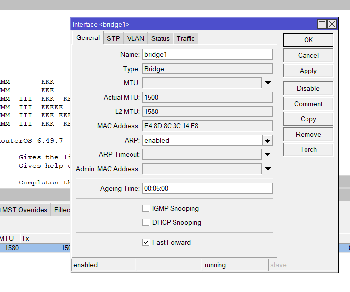

I have confirmed fast path is off, and both are in bridging mode, as I need a bridging firewall as my default gw is on the same subnet as my 13 private ips.

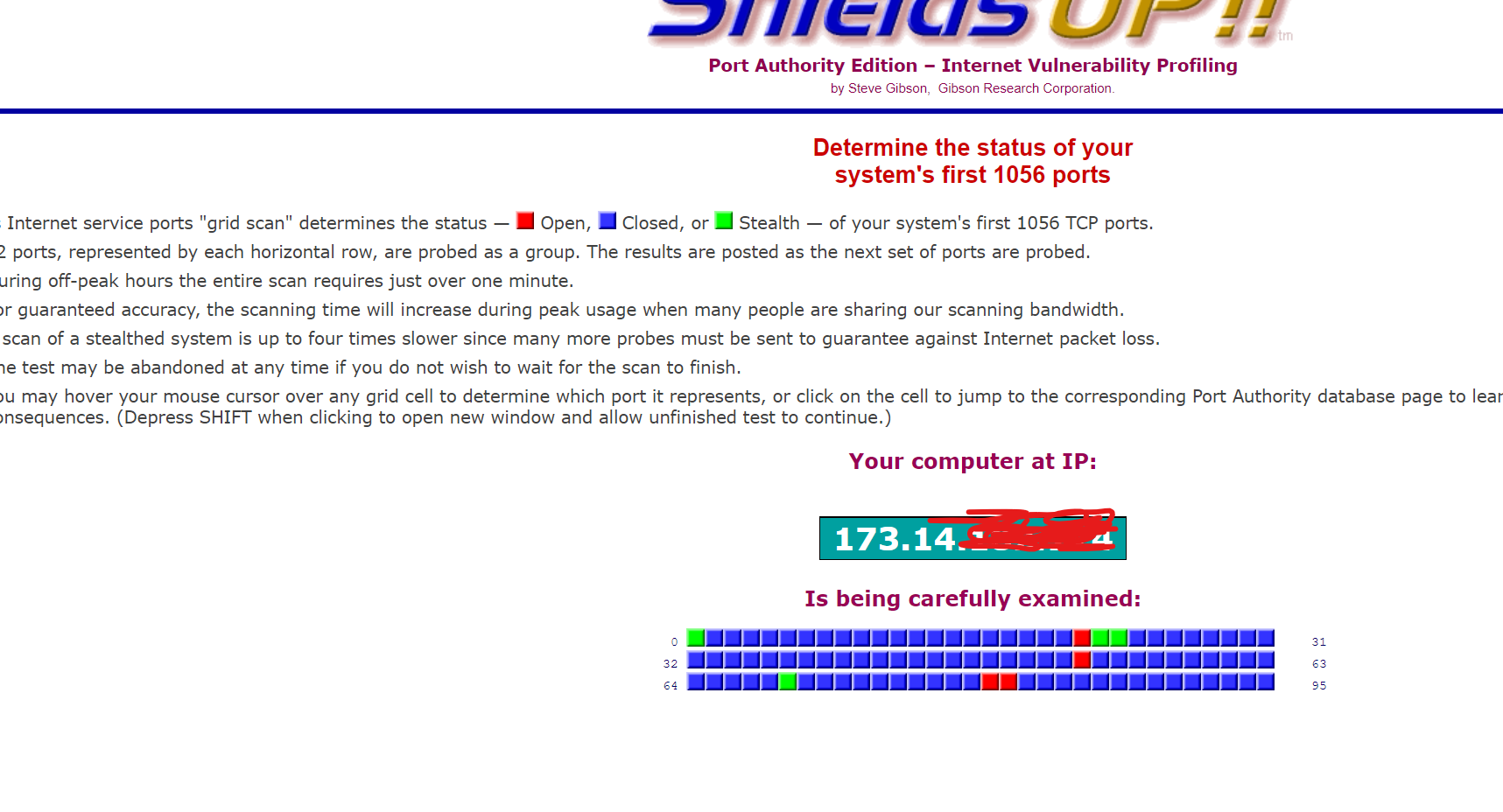

here is testing showing the firewall NOT working on the ccr1026

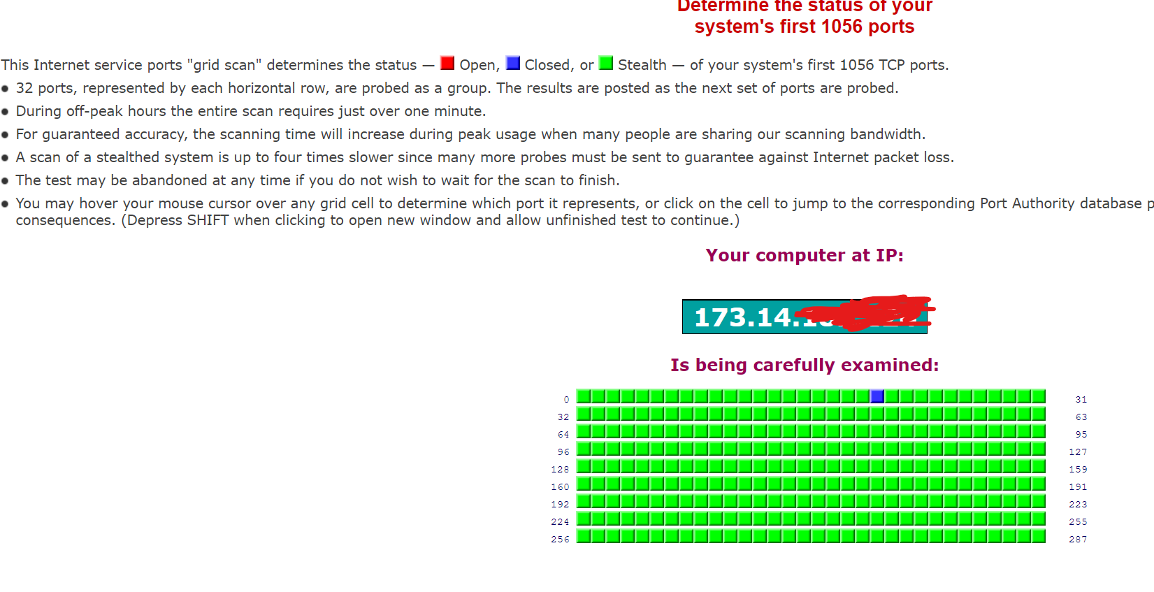

here is the testing showing firewall working on my ccr1016

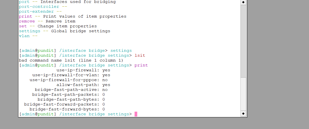

firured it ouit.. it was this setting. that does not show up in the interface.. the only way seems to be set it in the command line, and it is a strange one to set.. took me forever to figure out the set and get options dont work.. you need to use the edit which brings it up in vi
the use-ip-firewall needed to be set..
am i missing something ie is there a way to do this in the ui?

Yes. The IP firewall only operates on packets forwarded through, or input/output to/from, the Mikrotik itself. Enabling that setting forces packets bridged to be also processed unless handled by hardware offload (not applicable to the CCR1036). See packet flow here https://help.mikrotik.com/docs/display/ROS/Packet+Flow+in+RouterOS.

In Winbox select Bridge, in the Bridge window select the Bridge tab, there is a Settings button to the right of the usual Add / Remove / Enable / Disable / Comment / Filter buttons.

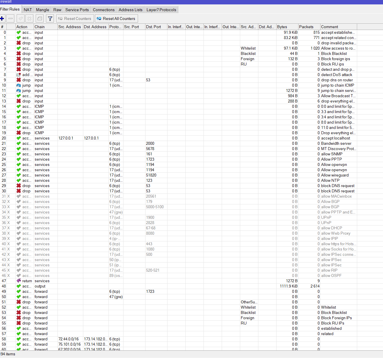

/export file=anynameyouwish ( minus router serial number and any public WANIP information ).
There is no GUI setting for use-ip-firewall ??
There is the standard
/ip firewall filter ( input chain: to the router or router services, forward chain: through the router lan to lan, lan to wan, wan to lan )
/ip nat
/ip mangle
/ip raw
All found in winbox under IP, and selecting sub-menu FIREWALL.

i found the setting now in the ui..

my firewall would not work with bridge filters it is pretty big ie 1400 lines. and loads about 32K addresss to block certain countries wholesale.
Bridge filtering only needs to be done in specific cases, much better off using standard firewall anyway.
