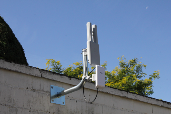

Set the omnitik in accordance with legal standards.
Set it to a bracket at a distance of about 20 to 30 cm from the wall.
See photo without nanostation2 M
