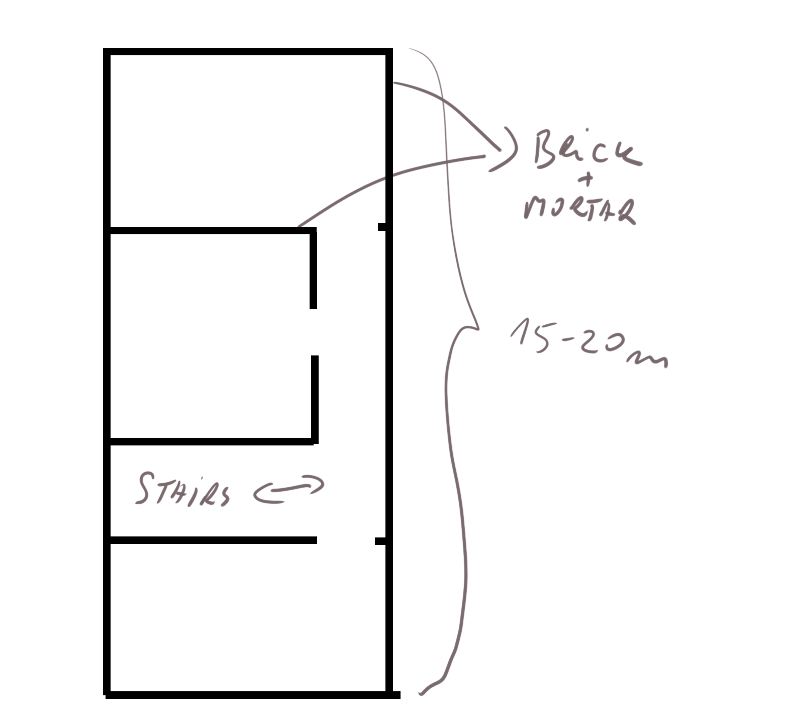

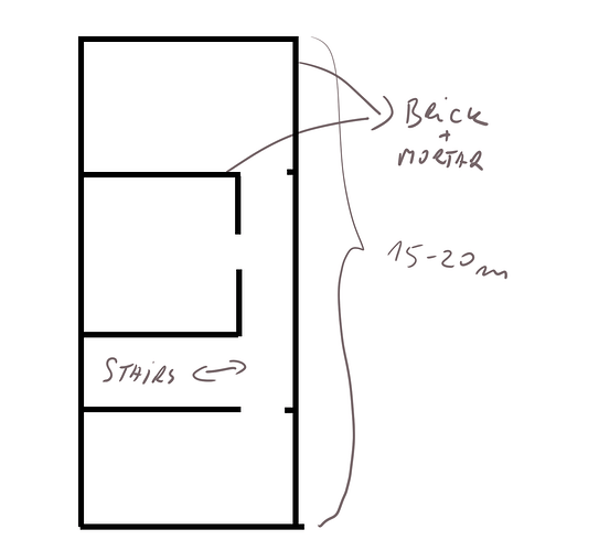

Do you have a floorplan?
Here it is, roughly. Still waiting for the actual plans. I have this + about 3x times the area with rooms below.
The wAP AC doesn’t look bad when wall mounted and provides excellent coverage. With brick walls, I would plan on 3 per floor just to insure 5ghz coverage.

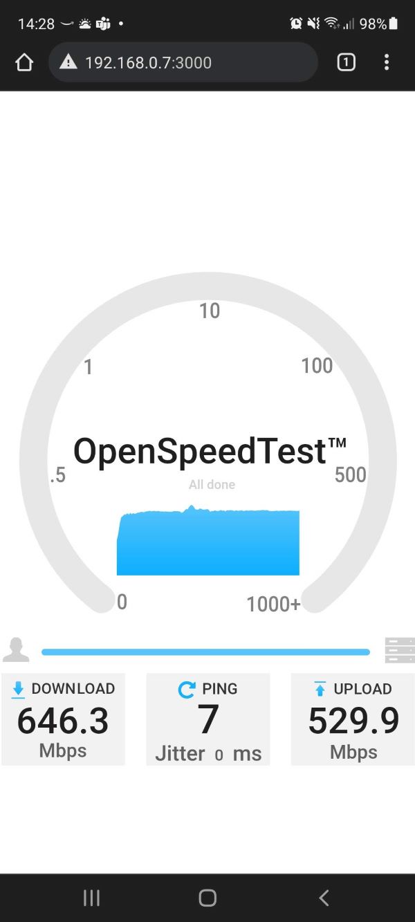

I swapped my cap ac (wall mounted) for a hap ac^3 (ugly) and the performance increased slightly…I now switchzed to wifiwave2 drivers and see double performance (around 550-600Mbps on 5G, compared to 240-280Mbps with default wireless drivers - tested with a samsung S20FE).

How so, if you have rooms below (assuming a floor below) then one would have roughly 2X the area?
Do you mean 3 floors?
In any case very rough rule of thumb is one per floor but all depends on walls/structure and placement.
Sometimes it may end up being one per wing (covers two floors in one area and the other covers two floors at the opposite end).
Moving them in to the middle step by step, until you have the correct coverage for ends and middle… etc. There is no right answer from us, it will take work at your end.

Here is my speedtest (running against my local NAS with a 10G link):
Wow. Amazing. No can do in MikroTik, altho to be fair MikroTik is routing company primarily + they try to be the cheapest and most flexible option. So I guess their logic is that if you want ultimate speed you can get it, but for basic access and “normal” speeds, they are more than enough. I mean, 20-30 mbps is more than enough for browsing, terminals, even video calls, etc. Higher speeds are great, but the reality is that most companies have relatively small uplinks.
Do not get confused…Wireless speed and LAN/wired should be compared by a factor of 10. So this is a 60Mbps Lan/Wan link.
