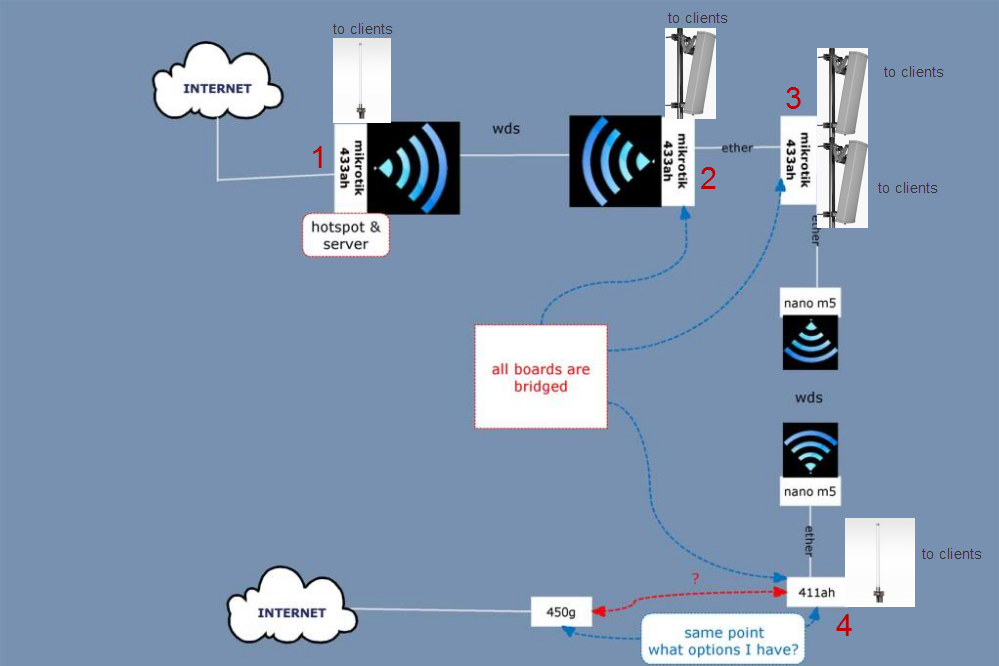

I have small ISP with around 40 users
see the pic
PLEASE
advice to separate users on the 2 wan
with centralized hotspot with radius in the server

i want to tunnel the second line to the server

In all honesty the diagram is seriously lacking, as is the apparent lack of any design other than ‘bridge everything’. The network is still very simple
What’s the topology actually look like? Where are the customers connecting? What’s the bandwidth provided and what is your upstream bandwidth?
It looks like it’s quite possible that some of those links will carry the same traffic twice going to the hotspot and then back out to the other internet connection. That may work with very little traffic but you’re basically cutting the capacity in half and just asking for trouble as the volume of traffic increases.
No one will really be able to give you much in the way of usable help until you give more information on the actual layout down to where the customers connect.

simply i have hotspot server in the main server (1 main board) with xr2 omni antenna for clients then xr5 directional antenna to an other xr5 station wds which connected to the second board (2) all port are bridged then connected to third board (3) by lan ether which is also having it’s port bridged (in these boards , all client connected by sector antenna ) finally the forth board (4) is connected via nanostation 5m and having all port also bridged where the clients are connected by omni xr2
in these location i managed to get a second dsl line
i have 450g board
i want to use these board to be connected to my network and benefit from the second dsl line
both dsl line are 20 mb
I’m giving all clients 1 mb
are there any way to tunnel the second line to my laptop or can be used in load balancing?
thanks in advance
If you want to share the combined capacity of the two adsl lines you first have to arrange that second line to reach the hotspot/main distribution server. Use a separate physical connection for that. You don’t want data to travel up and down your back hauls twice.
After that you then have several options for loadbalancing. Plenty of examples in the wiki and discussions on this forum. PCC works fine for me with 3 adsl lines but depending on the setup of your hotspot server and possible webproxy you have to decide what kind of PCC setup works best for the services you are offering.
After that you just distribute the capacity over your network. Try to avoid bridging as much as possible. When the amount of users and the amount of data transport increases routing or any other tunnel distribution protocols are much faster.

will physical connection is quite difficult for me
the second option is to tunnel this second line for my private using. is this possible? and how ? which protocol?
from bridging to routing ? I’m newbie how ?

As it is now if you tunnel the new internet connection to the ‘master’ hotspot server you’re going to be sending data over the same link twice in many cases. That is never a good thing.
If you’re using hotspot I’d push it out to all of the APs and have it authenticate against your master server. That way each individual hotspot can take the best route to the internet and the only common traffic would be authentication links to the master server.
If you try to put a lot of customers on your current setup it’s going to create horrible network conditions. You can grab some Cisco entry level books and study networking and basic design, but you really need to hire a consultant to fix things before it really becomes a problem.
