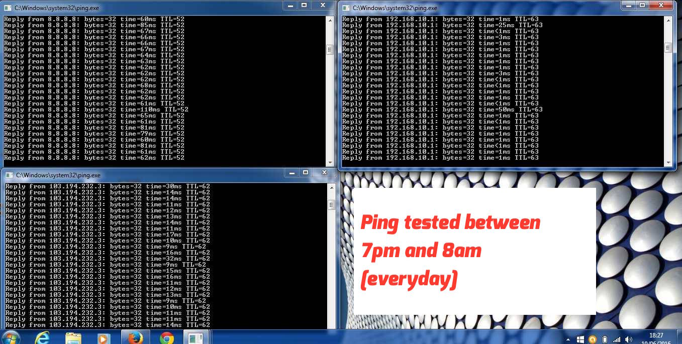

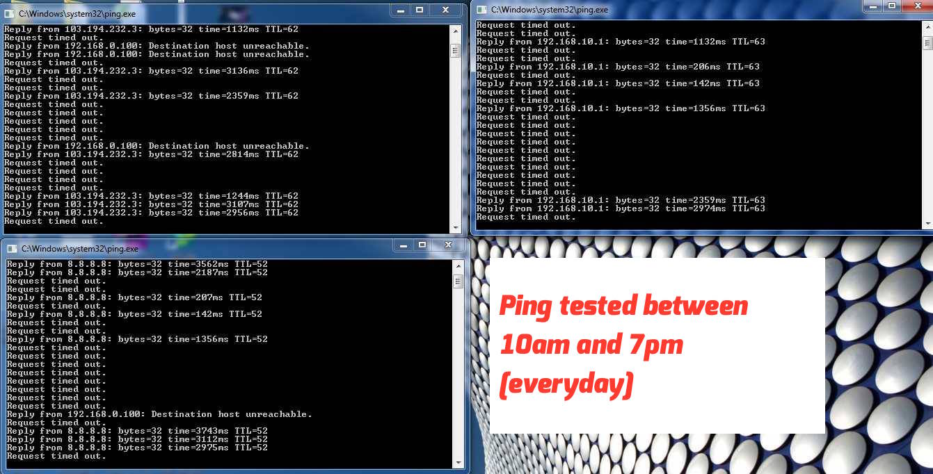

Since last 12 days, there has been weird things happening in the network.
From morning 10am-8pm, random 100-200 customers keeps on disconnecting and connecting.
But the same customers immediately get stable after 7-8pm normally.
Here is the screenshot of a customer whom I randomly picked.
He got 81 times disconnected between 10am till 7pm.
After 7pm till 8am next day, he has not disconnected even once.
What could be the issue ?

What is 192.168.0.100? Problem is between that and next router. It was specially designed that way, so you can start finding problems. Also use traceroute.
