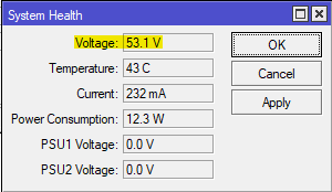

Currently I am using RB1100AHx4 in production, and for input power using recti -48v DC power.
For the DC connector I got it at purchase, and just plug in the - and + cable then connect it to the -48v or recti power supply.
To check the voltage and current ampere status in System> Health.
