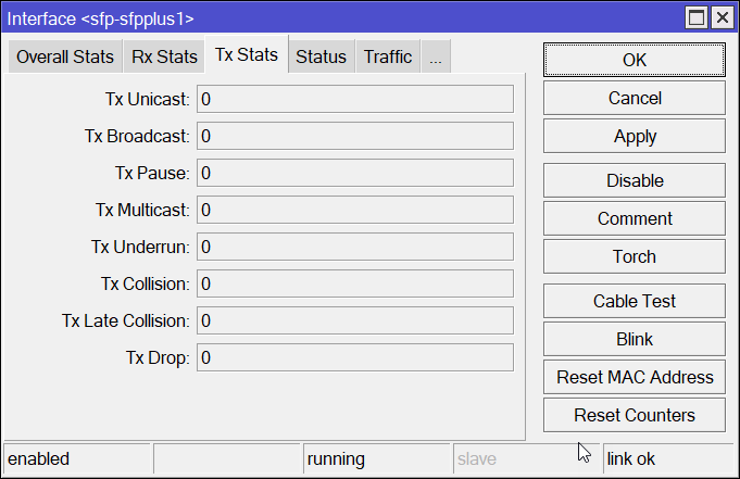

Well, got the kit, but I can’t seem to make it work. There is a connection, but it seems to be one-way. RB5009 is TX but not RX; while the CRS328 is RX but not TX. I’ve tried with auto-negotiation on/off, different speeds, but it’s only one-way. RB5009 shows status as Enabled / Running / Slave / Link OK / Auto-Negotiation Incomplete / Rate 10G / Full Duplex. CRS328 shows Enabled / Running / Link OK / Auto-Negotiation Done / Rate 10G / Full Duplex. I’ve tried switching the cable around, switching the transceivers around, rebooting both devices. Same results every time.
Are there settings that I’ve missed? Do I have faulty equipment? Switching the transceivers around would seem to eliminate them, right? Maybe bad cable? More likely, I’ve done something wrong or not done something that I should have…

The transceivers I have are the 10gtek suggested by anav above. The cable is a monoprice cable (https://www.monoprice.com/product?p_id=6385). The cable does crossover from one end to the other as you can see from the photo at the link. If they are swappable, I can’t tell. But they do swap position from one end to the other. And this seems correct with the results I see. The RB5009 TX is going to the CRS328 RX. But the CRS328 is not TX anything and the RB5009 is not RX. Why is the CRS328 not TX?
