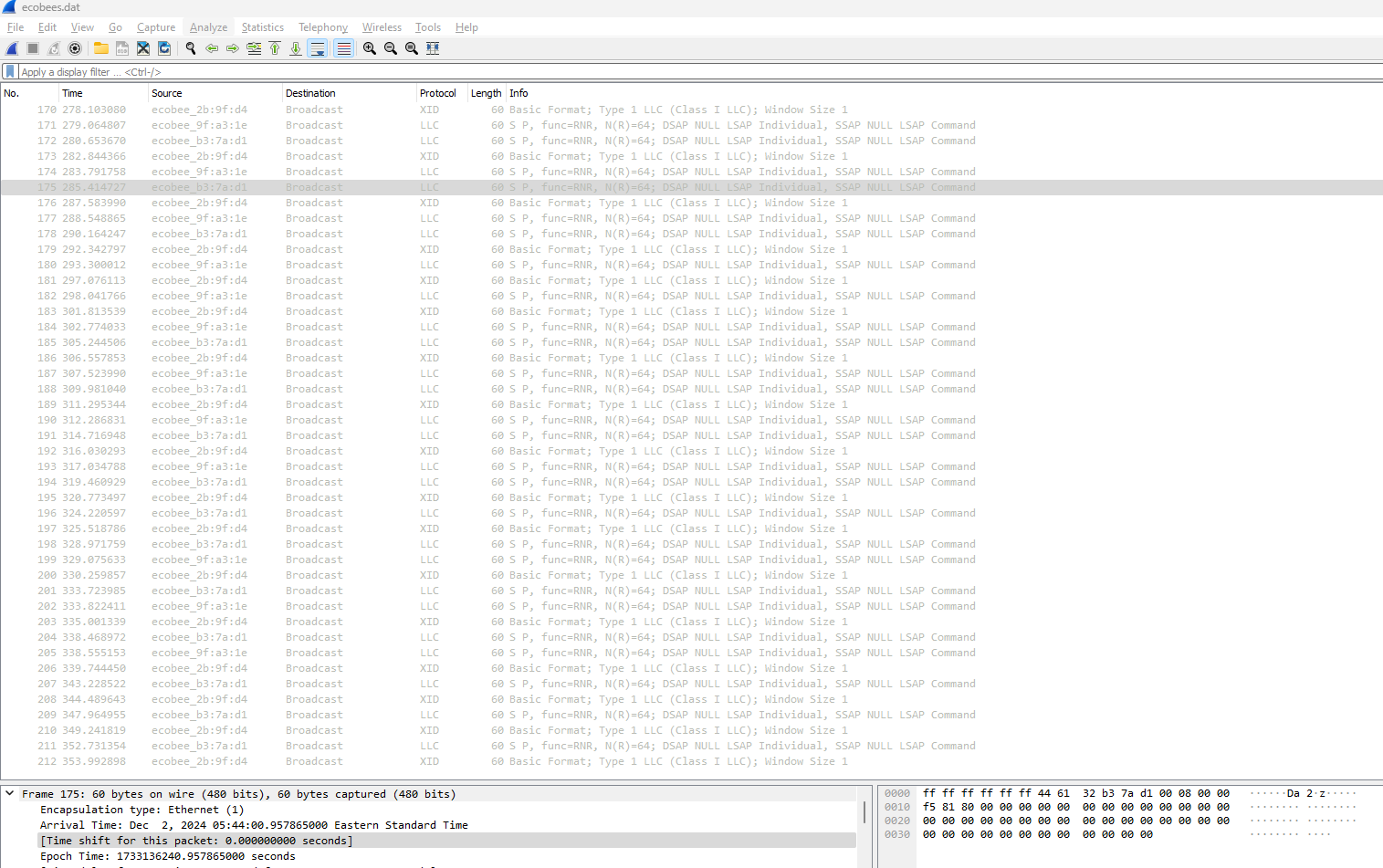

Can someone please let me know what might be going on with these frames?
The Ecobees are clearly sending frames to the Ubiquiti APs (ether 3 and ether 4 on the hEX), the hEX is seeing these frames (sent to ff:ff:ff:ff:ff:ff) but no responses are sent or heard.

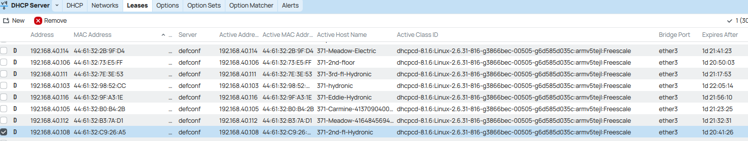

The hEX provides DHCP addresses for lots of other clients, including some Ecobees.

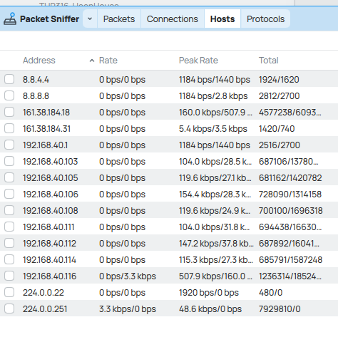

Before sniffing again, add interface=bridge or interface=ether3 to the filtering conditions (for this particular case, in other cases the need may be different). Once you sniff enough packets, run /tool/sniffer/save file=something.pcap (or maybe there is a button in Winbox?). Then download the file and open it using Wireshark, it should show you the actual contents and purpose of those packets.
From this screenshot, one can say that many yellow cars drove by the camera, but not how many of them carried teenagers with purple glasses. Wireshark shows you the latter type of information.
Totally brilliant approach!

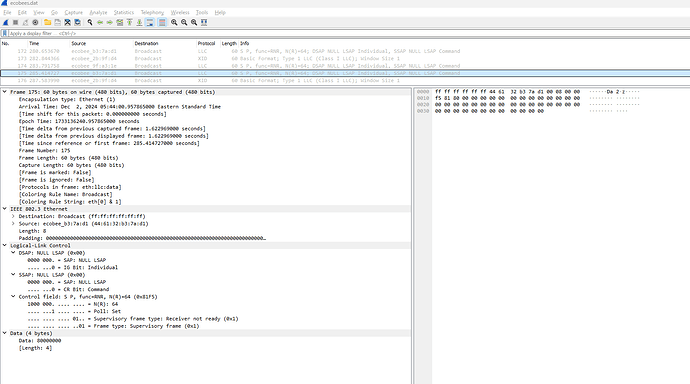

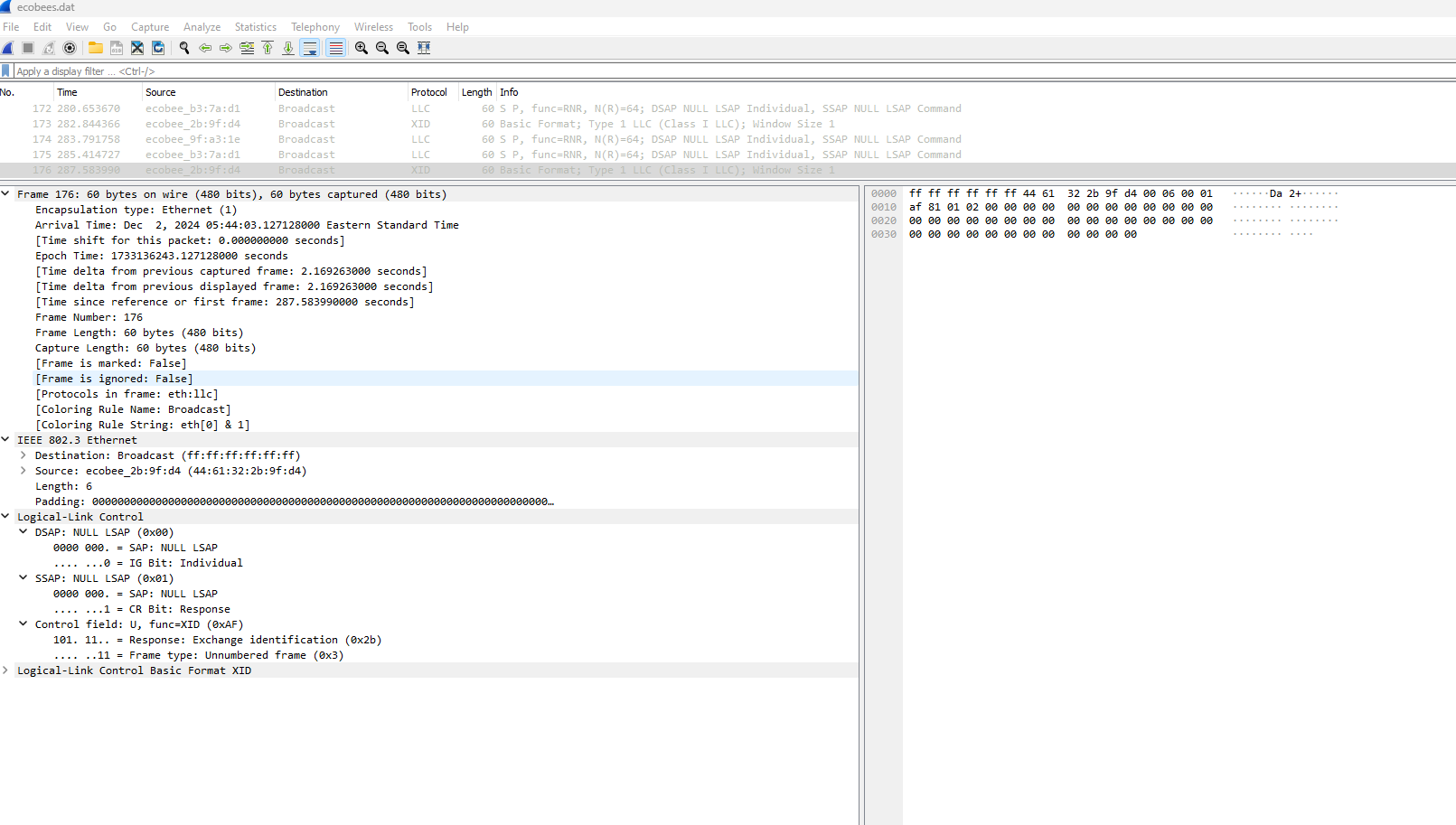

Unfortunately, I don’t see anything identifyable and useful in these packets.

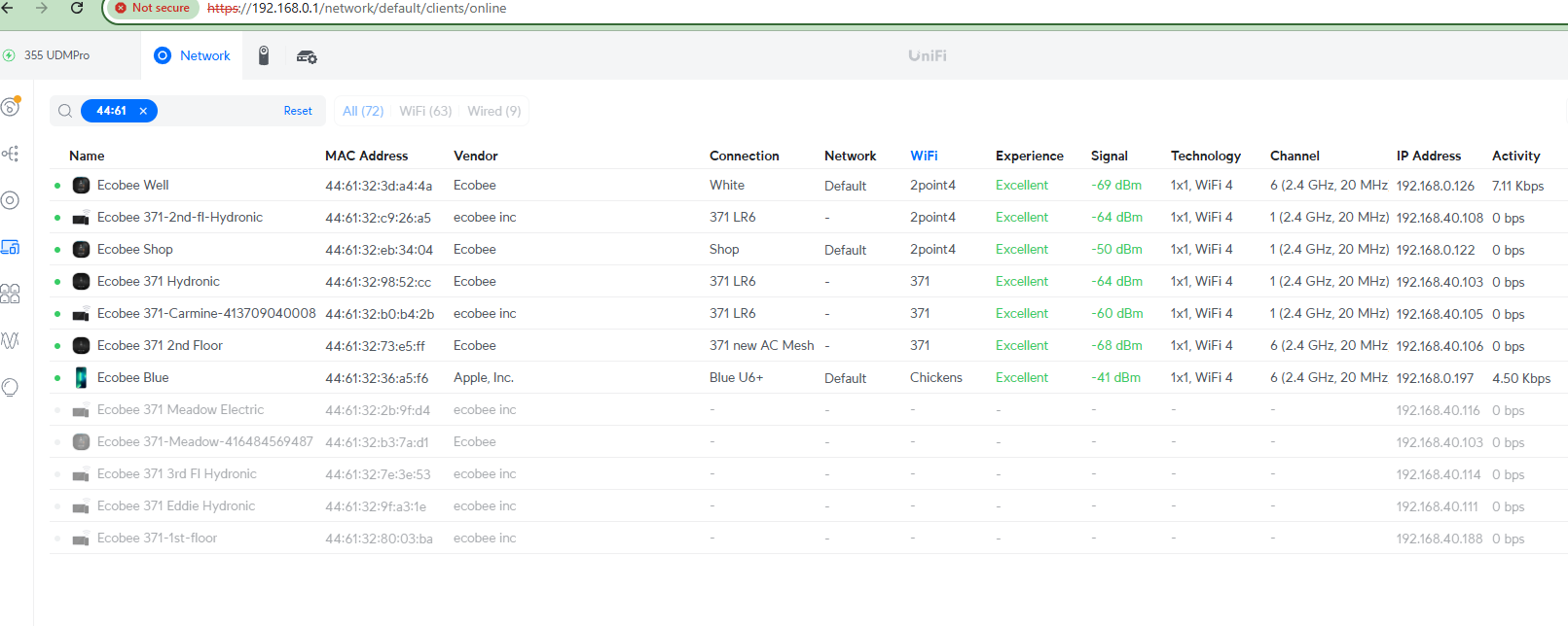

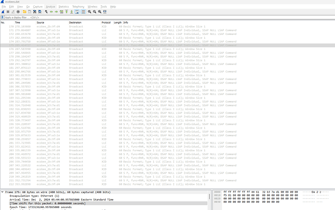

I should point out that (to me) this is completely bizzarre because the mac addresses on these packets are coming from (Ecobee) devices that are NOT connected (associated) with APs, as shown below.
The lack of connection is what brings me here to begin with. Then I sniffed for those mac addresses and found frames. It’s almost as if the APs here the frames via RF and pass them along to the hEX, but don’t actually establish a connection.
The useful part is that these are definitely not DHCP packets - actually, not even IP ones.
Another useful bit of information is that the wireless channel as such must be established (as in, the Ecobees did authenticate as STAtions to the AP, so you should see them in the wireless||wifi||capsman registration table if the AP is a Mikrotik one), otherwise you wouldn’t see Ethernet frames with their source MAC address in the sniff.
Wireshark has dissectors for pretty much every standard protocol, so this stuff seems like some kind of controller discovery proprietary to Ecobee.

They show up in the Ubiquiti management page as NOT connected. That means, there is no way to communicate with them via Ubiquiti’s management infrastructure.

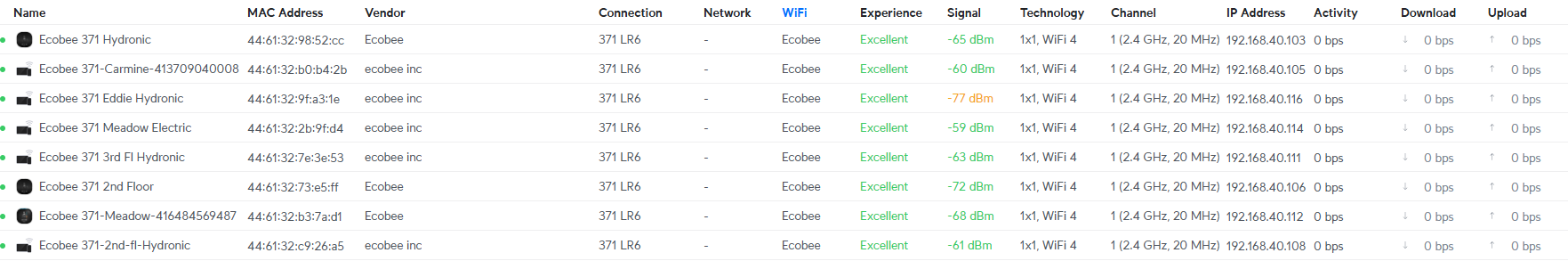

I set up a separate SSID (called a “wifi network” in Ubiquiti wording) associated with a single AP (no roaming) and only 2.4ghz.
I have the hex sniffing all 44:61 mac addresses (all 8 of the Ecobees at this one location).
Hopefully, they will stay connected.
If they don’t, and the hEX doesn’t fill up and crash or stop sniffing, I’ll have the sniffed packets file to see what happened.
One thing that is surprising is that the same broadcast packets are showing up at the hEX from the AP and from the Ecobees. No idea what they are, but I thought for sure they were a sign or symptom of the failure to connect correctly. That is, they are there even with properly connected Ecobees.
Thank you!
It’s been an hour and so far so good.
All 8 Ecobee’s remain connected to the single AP via ssid “ecobee”, and the hEX still hears them.

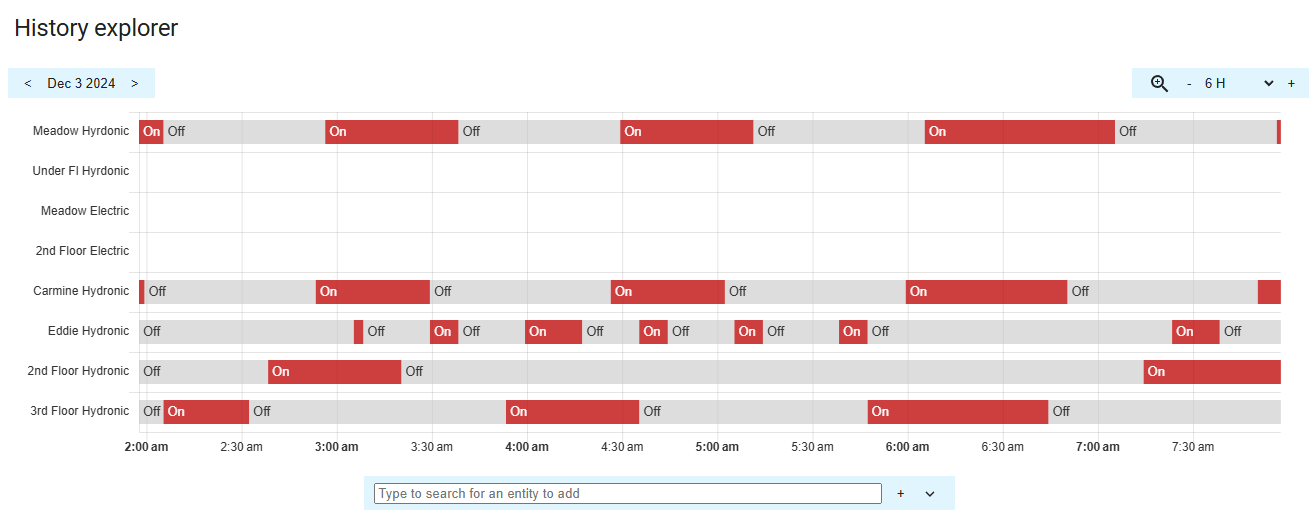

A morning status update: All is working. All Ecobees are still connected.
Had sniifer running all night, file size is 11MB; downloaded for future investigation; stopped and started sniffer again.

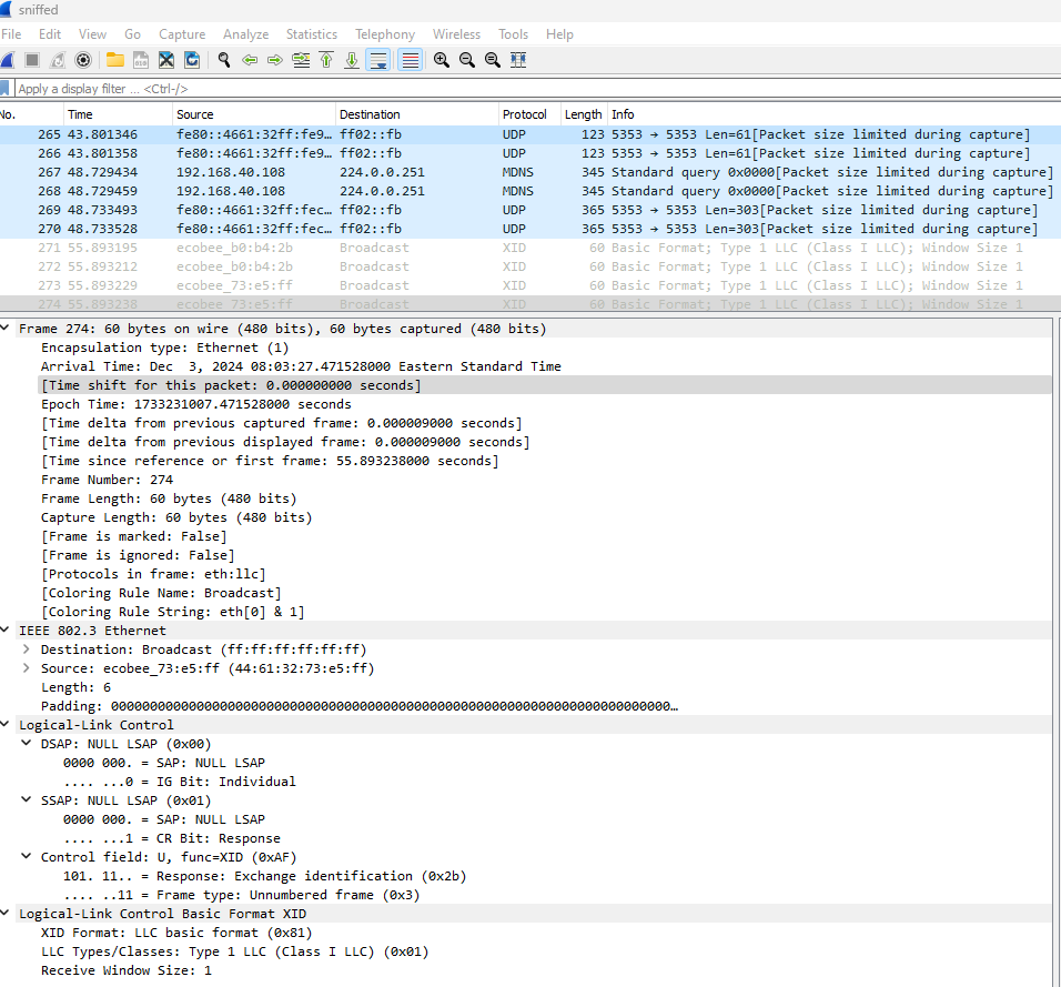

In case anyone is interested, here’s what this morning looks like:
Ecobee, totally unknown to me, just as all the specific Apple protocols are.

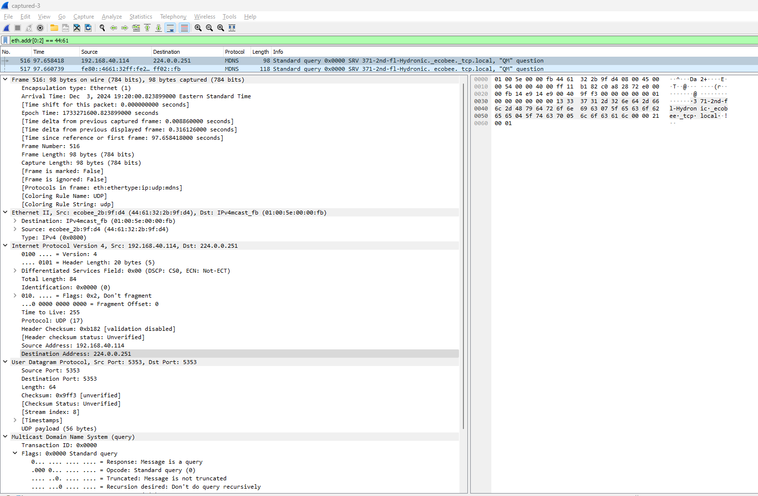

I see one Ecobee device sending ARP requests asking who knows – I don’t know why 1 ecobee needs to know how to talk to another ecobee. I thought they only talk to the Ecobee cloud.
And they are still sending broadcast packets using XID protocol.
And MDNS reqests to 224.0.0.251.

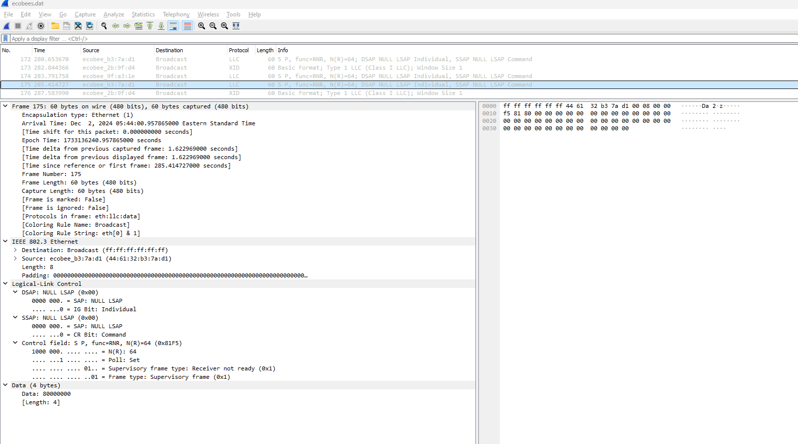

Then downloaded and opened in Wireshark, filtered on ether.add[0:2] == 44:61 and here is just one out of many frames. No idea what do to with this now.
