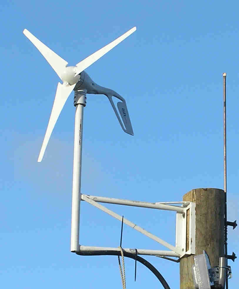

We have a site where a solar panel is supplemented by a windmill but after a solid week of cut-outs and reboots every few minutes and “jan/01/2002 14:00:02 system,error,critical router rebooted without proper shutdown, probably power outage” reports in the syslog we turned the windmill off, since when all has been fine.
We’re still investigating the problem but current speculation is that the windmill, which locks the generator up to prevent the rotor turning when the batteries are fully charged, was spinning up with charged batteries in gusty weather and the ‘lock-up’ function was causing either a voltage drop or ‘shock’ through the system which either caused the regulator to cut off the power to the board (an RB532), or was actually causing the board to momentarily shutdown.
So if you’re thinking of getting a windmill be sure you understand how it’s going to affect the system.
If anyone else has experienced this problem we’d be interested to learn to solution.

The Air Breeze 200w turbine.
We’re still trying to find out what was happening.
I had pretty much the exact same problem with the Air X. But mine was worse - about 30% of the time the board would reboot, and the other 70% it would freeze.

I ended up getting a 12V UPS from http://www.powerstream.com/12V-backup.htm and attaching it to a small 4 Ah backup battery.
That got me from a crash every 1-2 days to a crash about once a week.
I then added a 4700uF capacitor in parallel with the load. Since then, 1.5 months of 100% uptime.

The problem may not be with the windmill per se. It’s connected directly to the batteries as it has its own controller but the solar panel is connected to the batteries through a solar controller and the wireless gear takes its 12v feed from the solar controller. The problem may be with the way the solar controller reacts to the battery voltage as it is affected by the windmill - it was very noticeable that the problem was worse at night. We’re still trying to nut it out, but the site is not very accessible which makes investigation difficult. We don’t want to go up there until we’ve at least some idea what’s going on and what the solution might be.

Your approach is a patch and it may be in the end the only solution for us but eben uses the same turbine without suffering the same issues which suggests the problem lies elsewhere in our system, and we’d rather fix the problem than patch over it.

I got the same configuration of eben, with 3 windmill in the same site ( we are in a windy and sunny place, so we are plenty of power.)
No voltage issues nor disconnections.
The windmill is Air X too, and it should have his own charge controller (IIRC)

My vote would be to power the wireless gear direct from the batteries but I’m outvoted on the grounds that if both windmill and panel “disappeared” (to adorn someone else’s country estate!) we wouldn’t know until the equipment had drained the batteries, and as they are gell-cell 6v ones that could be damaging.
