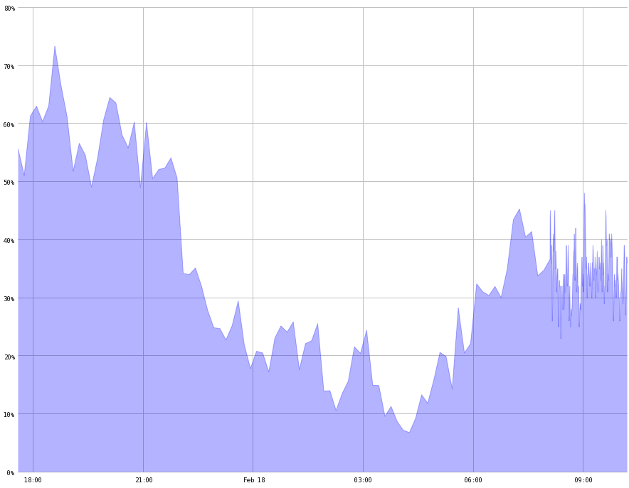

I might do that. I am running ospf though from other routers and don’t want to have to upgrade all of them yet. The system is running good and everything seems to be working, just not sure why it uses so much resources. I attached a dude chart of the CPU usage. It looks like it calmed down a little throughout the night. Funny thing is 21:00 to 23:00 it was passing around 20mbps and resources were lower. It doesn’t appear to be a bandwidth issue even though it calms down later in the night? Strange stuff
