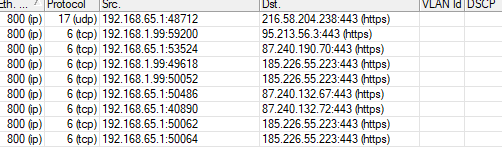

I attach the Torch output, .65.1 is the WAN2 local host address, and .1.99 is the source LAN IP.
There is only .1.99 which generate traffic here
IN my opinion the problem here is that the NAT is not processing all packets before routing, maybe this is caused by fragmentation? I have no idea

Well what is clear is that your original post in no way shape or form resembles the config.
There is only one WAN, coming in on ether1, but you have no DHCP set for it, and no IP address for it and to make matters worse you have ether1 on one of the TWO bridges.
Funny thing to make a capac into a router, its possible I guess but not my first choice.
So in reality you have one WAN but wish to push one IP through wireguard for TV it seems.
Why do you think the input chain is the place for a rule like this?
add action=drop chain=input dst-address=192.168.1.0/24 src-address=10.0.0.0/24
Its also not clear what your wireguard connects to?? 3rd party VPN server?
Dont think so, but I see no endpoint address or endpoint port to indicate your device is a client peer for s
handshake??????
Furthermore you have no input chain rule for handshake even if you were the server.........
So we need clarity on what is going in with Wireguard, since if a client you need to get rid of responder,
enter in the endpoint information and add persistent keep alive, just for starters.
The wireguard would be part of the WAN interface list and then you wouldnt need any Nat rule for it.
Speaking of NAT rules, they are all over the map and look wrong!
Very rare and frankly cannot recall seeing routing marks in NAT rules, so for starters get rid of them.
I dont see NAT rule for normal WAN traffic??
Old, default static DNS should be removed
/ip dns static
add address=192.168.88.1 comment=defconf name=router.lan type=A
Some funky nat rules dst/src nat but will assume you are doing something with a purpose there.
In summary, still no need for mangling that I can see to move a single LANIP out the wireguard tunnel as I described.
being sincere, I knew the config was quite rich and it rises other questions that has no inpact, but make us loose time. This is way I wasn't happy to post it.
There is only one mikrotik on this place, and it's enough for it, no sense to spend more money.
This XL gives wifi to staff, wifi to clients (connected to the second bridge), a VPN for TV by wireguard (only when it is needed!)
No need to use this Mikroti as gateway/NAT, the gateway is the main router, the frames come from the TV to XL as it is specified as a fake-gateway by DHCP (option 3), these internet requests are simply redirected to the gateway (when the mangle not working), the gateway is on the same LAN and forward directly to TV the answer by its IP/arp, no need to NAT these requests, it works.
The wireguard is VPN, it works as receiver for some reasons, don't worry about that, I assure the link works as a phisical WAN2, and on it there is a default route to that.
The static DNS has no influence about this problem, I forgot about that, I deleted..
I need to mangle, without that the traffic will go to the default route, I only now this way to force to route to WAN2. A smple NAT in these cases will not help, it is needed to force a route, as I know.
Let's please focus exactly on the problem I have, the mangle works, it forces route all packets to the WAN2, no questions about that, I'm happy with that, it works as expected. The problem is, not all those packes are NATed, I can say only 50% of them are NAT, the others has the source IP of TV, why? That has no sense.
Another problem with 7.21.1 version, the tools/ping changed, from the router I can't send ICMP packts to 8.8.8.8 by the WAN2 using the source adress of WAN2, but I can ping the WAN2 remote host, the next hope, thse packets are sent on WAN2 link. The ping is wrongly following the main table instead the interface I specified by the WAN2 source address.
In this OS version I can't more select the isource nterface, they canged the ping window program, is this in the end a bug? It looks like! ANt the missing NAT can be a bug too..
Wish I could help, its beyond my scope of knowledge. Not sure how one can route traffic if not using the MT as a router??
About the ping change, you can use the percentage sign to select interface, see:
Tools -> Ping: interface field is missing
Not necessarily applying to your setup but - generally speaking - you can consider routing rules/policy routing as a "better" (but coarser) kind of sieve, IF what is needed can be done with routing rules, it should be done with them, and mangling should be reserved to what CANNOT be done with routing rules.
If the "strange" NAT behaviour remains the same with either your mangles and with the set of routing rules anav suggested, it should mean that the issue is somewhere else.
When this kind of things happen, i.e. something works with version x but suddenly breaks with version y, it is very difficult to understand if it worked before because of a subtle bug that was fixed by the new release or if it fails now because of a new bug introduced in the new release.
If you are sure that exactly the SAME configuration works with a 7.20x version and now it doesn't work anymore with 7.21.x, you should open a ticket with Mikrotik support about the matter.
Thank you, this problem is now solved, the ping works and I see it going on WAN2
I used 8.8.8.8%wireguard-Aruba
Thank you mate, Mikrotik is powerful, many things can be done with it, you just focus on the protocols and you may find different solutions.
In my case I've created a fake gateway, so by the ARP table the TV is sending to Mikrotik, its IP with TV(source):internet(destination), the XL has nothing to do with this packet and it sends to its main gateway. The gateway cares of the source IP only, not the source ethernet fram address, and it correctly replies back to TC according its ARP table.
In this way when I mangle the XL route the packets to the WAN2, expecting to NAT them all. NAT by the source IP works bad as well as NAT a routed marked packet.
The main topic here is that that router is effectively mangling and mark the packets, bucause it forces them route to the WAN2, but sometime it is missing to NAT them bufore sending, and that is a no sense
Sorry, I was editing my previous post while you replied, please read the newly edited version,
I've read, thanks,
doyou thing I can easly downgrade? Because upgrade to 7.21 needs 7.20.7 before, and ths makes me worried about loosing the actual config.
To downgrade is just necessary to upload the other firmware into files and reboot?
It is one of the few cases where the extremely terse - not to say scarce - official Mikrotik documentation is enough:
Remember that you need ALL the corresponding "extra" (if any) packages you have installed now uploaded.
In any case do BOTH a backup and an export before attempting a downgrade.
That device has only 16 Mb storage, so it has to be seen if you have enough space.
Otherwise you will need a netinstall (which is a huge PITA).
Yes, better avoid netinstall. I'll have a look, at this time I'm full of work, and the problem I?ve temporaly solved remove NAT, let all packets go wrongly to WAN2 and configuring a subnet compatible to the remote host that allows to NAT to interent, that's nasty but works.
I'm also going to open a report officially
