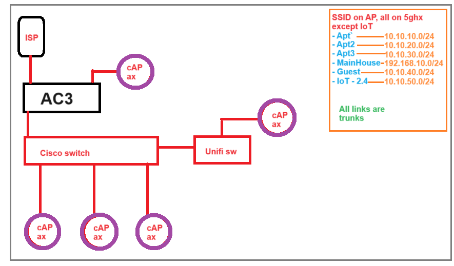

Here is my requirement
ISP ↔ HAP AC3 ↔ CISCO SW ↔ cAP ax
I want to create the following
SSID
  • Apt1 / 10.10.10.0/24 - vLan10
  • Apt2 / 10.10.20.0/24 - vLan20
  • Apt3 / 10.10.30.0/24 - vLan130
  • Guest / 10.10.40.0/24 - vLan40
  • IoT / 10.10.50.0/24 - vLan50
  • House / 192.168.10.0/24 - default
I want to configure the ports and wifi on the AC3 as hybrid.
The ports on the cisco where the AP connects are all trunked already.

As far as I can see there is no mention of capsman here and every AP is on separate subnet, so why you don’t just untag them and leave trunks between AC3, CISCO and USW ?

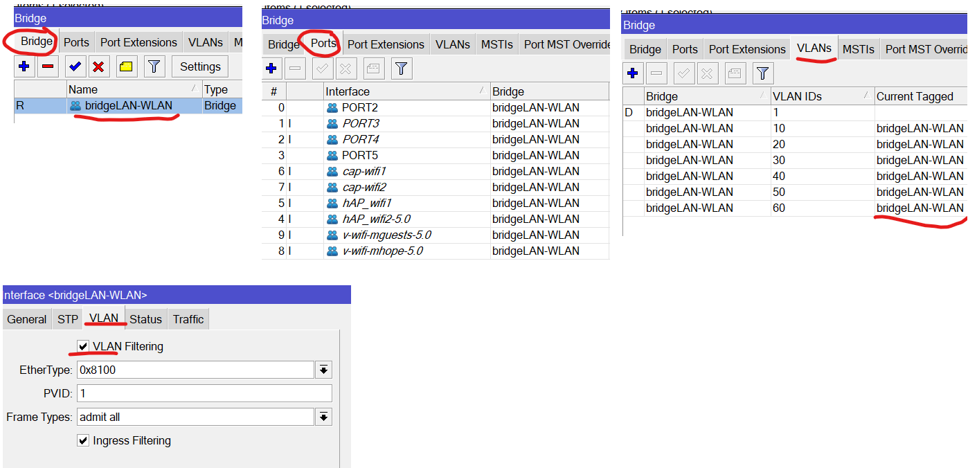

It would be best thing to provide us your current configuration.
Hi
Here is my configuration. Everything works without without VLAN filtering on the bridge and no tagging on the bridge vlan.
I want to ensure all settings are correct before proceeding to adding cAP ax and configuring firewall between the AP.

add name=bridgeLAN-WLAN
set [ find default-name=ether1 ] name="PORT1[WAN]"
set [ find default-name=ether2 ] name=PORT2
set [ find default-name=ether3 ] name=PORT3
set [ find default-name=ether4 ] name=PORT4
set [ find default-name=ether5 ] name=PORT5

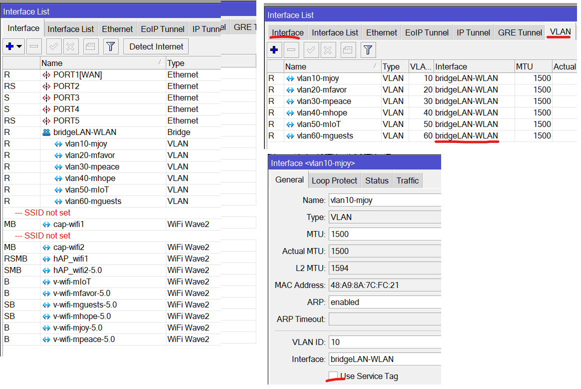

/interface vlan
add interface=bridgeLAN-WLAN name=vlan10-mjoy vlan-id=10
add interface=bridgeLAN-WLAN name=vlan20-mfavor vlan-id=20
add interface=bridgeLAN-WLAN name=vlan30-mpeace vlan-id=30
add interface=bridgeLAN-WLAN name=vlan40-mhope vlan-id=40
add interface=bridgeLAN-WLAN name=vlan50-mIoT vlan-id=50
add interface=bridgeLAN-WLAN name=vlan60-mguests vlan-id=60
add name=WAN
add name=LAN
add name=VLAN

add bridge=bridgeLAN-WLAN interface=PORT2
add bridge=bridgeLAN-WLAN interface=PORT3
add bridge=bridgeLAN-WLAN interface=PORT4
add bridge=bridgeLAN-WLAN interface=PORT5
add bridge=bridgeLAN-WLAN interface=hAP_wifi2-5.0
add bridge=bridgeLAN-WLAN interface=hAP_wifi1
/interface bridge vlan
add bridge=bridgeLAN-WLAN tagged=bridgeLAN-WLAN vlan-ids=10
add bridge=bridgeLAN-WLAN tagged=bridgeLAN-WLAN vlan-ids=20
add bridge=bridgeLAN-WLAN tagged=bridgeLAN-WLAN vlan-ids=30
add bridge=bridgeLAN-WLAN tagged=bridgeLAN-WLAN vlan-ids=40
add bridge=bridgeLAN-WLAN tagged=bridgeLAN-WLAN vlan-ids=50
add bridge=bridgeLAN-WLAN tagged=bridgeLAN-WLAN vlan-ids=60
add interface="PORT1[WAN]" list=WAN
add interface=bridgeLAN-WLAN list=LAN
add interface=vlan10-mjoy list=VLAN
add interface=vlan20-mfavor list=VLAN
add interface=vlan30-mpeace list=VLAN
add interface=vlan40-mhope list=VLAN
add interface=vlan50-mIoT list=VLAN
add interface=vlan60-mguests list=VLAN

You said without tagging on the bridge but you tagged VLANs on the bridge:
VLANs will not work until you enable VLAN filtering on the bridge. Also you didn’t defined VLAN id for any interface.

Here are screenshots of my configurations
BRIDGE:
INTERFACES
You don’t need to use service tag. Okay now you created VLANs, did you try to assing VLAN to any interface so you can test it ?
