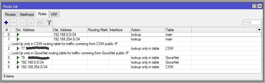

For such a simple thing, can it be done with IP->Route->Rules. There is not a lot of documentation about Route rules, but I use them. I think when the packet arrives at the WAN interface, the destination IP address of this packet is the WAN public IP address. In my case, both IP addresses of two WAN links are the same all the time. My ISPs never change them when the connection is restarted. So when the router sends an answer to the arrived packet, this answer will have the source IP address - public IP of the interface. In the case of port forwarding, at first, NAT will change public with private IP and then private with the same public IP.
If I have a Route rule which said - if source IP is ISP-1 public IP, send the packet from WAN-1 and the same for ISP-2. Something like this in the picture below.
As seen in the picture, if destination is one of local networks, router will search for route in main table / rules #0 and #1 /. But if first LAN network is the source and the destination is not another local network, router will search for route in GoceNet / ISP-1 / routing table - this is rule #4. Route rules are processed top to bottom like firewall rules. What do you think.
Routing rules work great for access to router itself (or generally with public addresses). Problem with port forwarding is that response packets from internal server have server’s internal address as source. It gets changed to public address, but it happens after routing decision.
I understand now. So I will leave rules with source IP addresses of WANs - the router will use them for example to respond pings to WANs IPs, or they are useless? But I will need also to add:
