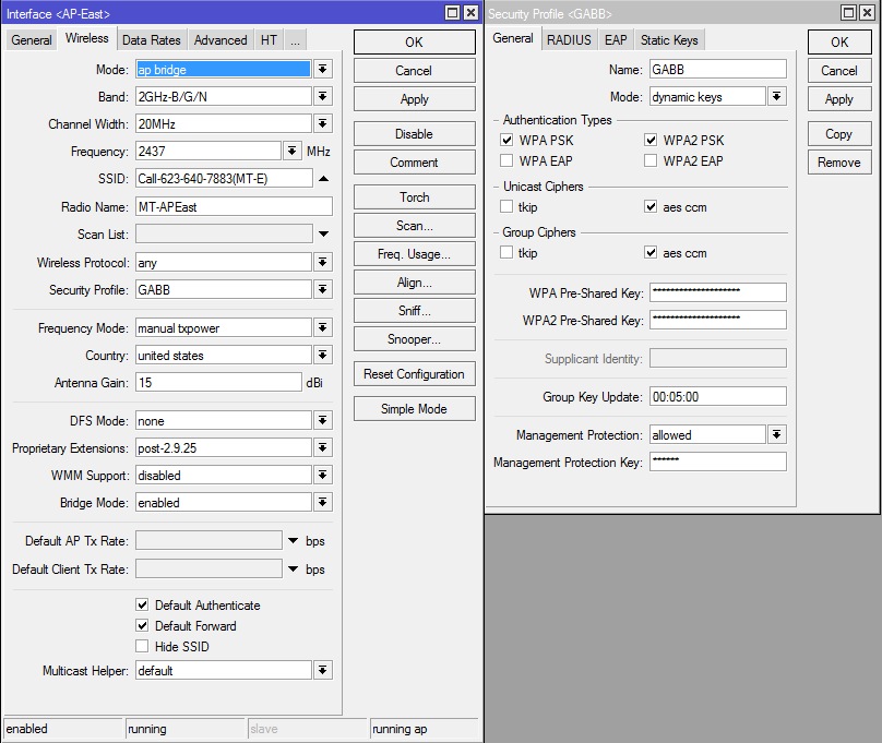

Here is one example. Here is the configuration of the AP:

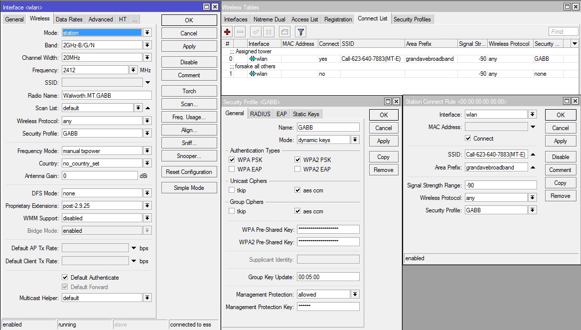

Here is the configuration of the CPE:
I can discern no difference between the parameters the AP is supplying, and the parameters the CPE is requesting. (Yes, all the starred out fields are exactly equal; keep in mind that the CPE does eventually match up with the right network.)

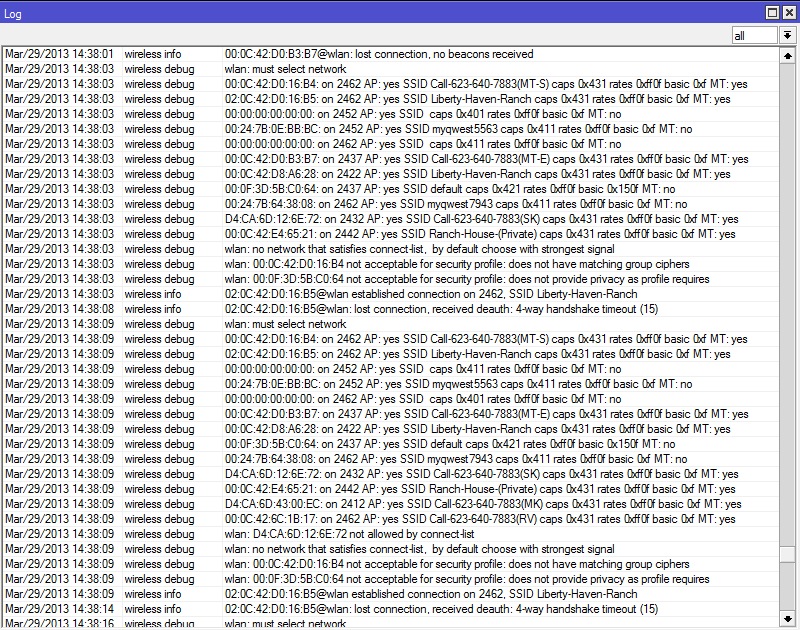

Yet, here’s the behavior I get upon disconnection:
Is there a mismatch somewhere in here that I am overlooking? Are there some other panels I should be examining?
Boy, I wish that there was some sort of a debug flag I could turn on that would log why the CPE doesn’t think it matched each of the networks. Even if it only gave me one disqualifier at a time, I could eventually conform the two sides. This way, it’s all guesswork. :frowning:
