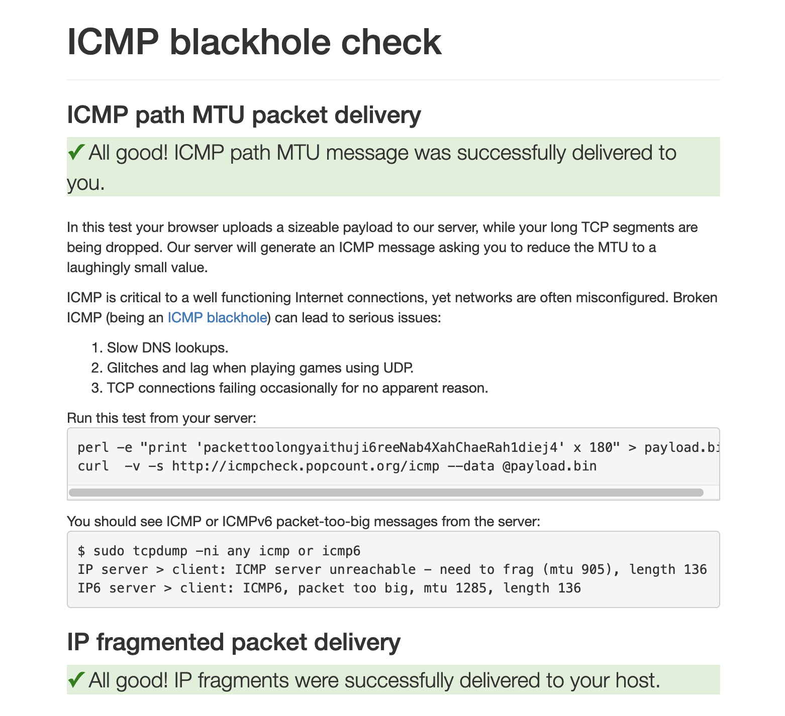

No! Re-read what @mkx wrote above. You should not blindly block all kind of ICMP messages. Try these test pages:
http://icmpcheck.popcount.org/
http://icmpcheckv6.popcount.org/
? No issues here from LAN and restricted VLANâŚ
and fw filter rule is from defconfâŚ
egress icmp ofc is not blockedâŚ
Edit: Also tested over all my back to home VPNs - OpenVPN, Wireguard and Wireguard over Xray tunnel (VLESS+Reality), still no issuesâŚ
