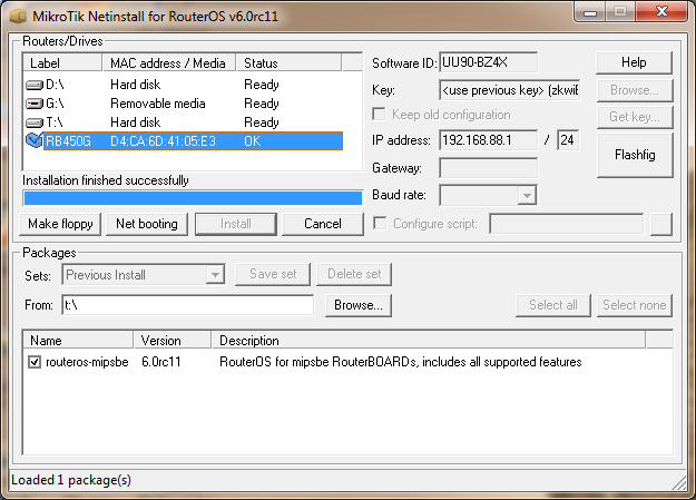

As atachement image show I tried to restore the device using netinstall. Every netinstall attemp was succesfully. I tried multiple versions 5.20 to 5.24 and even 6.0rc11 but after reboot routerboard does not boot properly.
It seem I have to repair the bootloader but I don’t know how.

Try booting with backup bootloader.
Here is how from RB450G manual
There are two boot loaders present on the NOR flash memory chip. The main one, that is executed by
default, and the Backup, which is built-in failsafe. In case something goes wrong in the upgrade process, or
you have set some incorrect settings that render it unusable, you can load the Backup boot loader by
holding the Software Reset 1 button (S301) connecting the power, and then releasing the button/jumper.
The Backup boot loader uses Default settings, which can not be changed. It is also not possible to upgrade
it. In case the Main Bootloader is damaged, RouterOS v3.23 supports Permanently setting the Backup Boot
Loader as Main (thus avoiding the need to hold the button).

I solved it! Thank you very much!
It seems that I should press reset button for at least 10 seconds to activate second boot loader. Less than that - no effect - that was the issue regarding no output on serial console. After that a simple boot loader reset and a restore of boot order to nand-if-fail-ethernet restore the device to working state.
