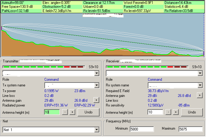

i have to establish a 15 kms PTP link in hilly area…

According to your graph the 10m is too low for that link - the 1-st fresnel zone has obstacles and if you happen to have any trees/forest then it may be blocked wholly.

hi agreed… 10 m is the original building height from the ground level… i might go another 5 meter up by putting up a single pole… the user is not ready to spend on tower constructions…

Link Distance 14 Kms approx…
LOS : ok… [image given above for reference]
so now investing in a 29dBi dish [ http://www.telimart.com/pdf/antennas/dish-antennas/4.9-5.9/hpd/hpdpd/TM55L-DPDISH-29.gif ] + RB911G-5HPnD would be wise??

I think that the 29dB parabolic antenna will be better. It is possible to mount the box for rb911?
