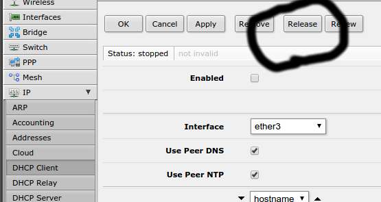

Maybe you only get one wan ip from your isp.
If soo, you need to release the the old wan isp ip from your old router, before you get a new wan ip to your new router.
Connect your old router first and then press release.

Go to IP-address and delete the IP-adress on the DHCP-client
Go further to IP DHCP-client delete the DHCP-client and make a new one
You got now a new IP-adress from your provider if not restart the isp modem
and try again.
