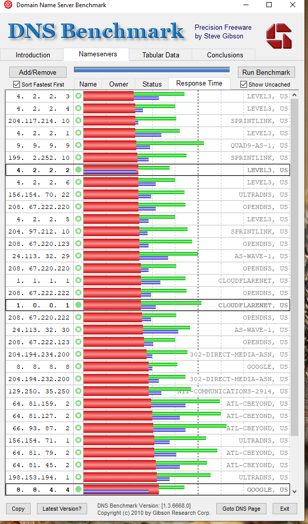

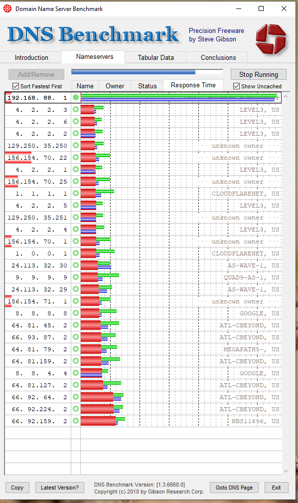

I have been having an issue with my mikrotik DNS being really slow in regards to DNS requests that aren’t cached. I thought mikrotik acting as the DNS server only affected cached and not the uncached, but when I set my lan to be the server, it somehow manages to slow down uncached DNS requests. The images are the results of Mikrotik as DNS and not as DNS.

On the X axis, you will notice a dark dashed line going up and down. This line is equal to 180 milliseconds.
When not using mikrotik, dns queries are solved at or less than 180 milliseconds. But when mikrotik is the dns, the queries are being resolved at 1,260 milliseconds… this equates to mikrotik taking 7x or 7 times as long to resolve the exact same queries.
As for the size and equipment, it is the rb750r3 and it is being used in a home of 5 people with multiple devices. The cpu usage is low and the ram usage is low even when performing the test.
I stress out because when the dns queries show the latency in the dns tester, there is also excessive latency on the rest of the network, something that doesn’t happen if mikrotik is not being used for dns. Ultimately the network comes to a hault, netflix stops, games are unplayable, and its only an issue when mikrotik is the primary dns.
