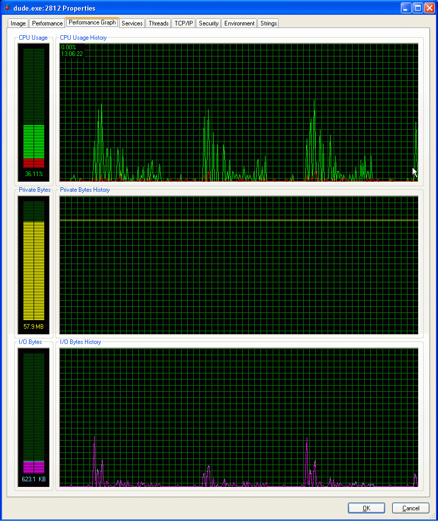

What it seems to happen:
The CPU for the dude.exe process is almost idle from the second 1 to 20 of each minute. After this, it has a peak followed by some activity till the second 5 of the following minute.
So I seems that it would be safer to stop the process in the second 6 of the minute.
The scale of the graph below, is as follows: a line of the grid is 3 1/3 seconds, and 3 squares of the grid are 10 seconds. The arrow of the mouse points to the second 22 of the minute.
I have told you what I thought, but it looks I’m wrong. I also have told you what it seems to happen. Is there anybody who can tell us what’s the truth?
It’s impossible to find an exact instant of time to to the restart, because the Dude does not probe everything at once.
The service restart just takes a couple of seconds and I’ve never seen anything happen because of my daily (at night) service restart.
I have.
I have upgraded to release 3.0 beta 8, and now I’m testing if it stops polling, so I’m not restarting the service.
When I was in 3.0 beta 7 I found that the graphs of response time or traffic had deep notches at the time when I restarted Dude.
When I performed the reboot of my PC I found that sometimes, the graphs of the previous hours were lost (usually about two days of graphs).
Now I’m trying to stop at the second 5 of any minute, this monday I got no lost information.
Regards
Hm, maybe it’s because of the 3.0 beta version. I’m running 2.2 and restart the service every night. No dips to be seen in any graph. (I’m monitoring a few hundred devices, so it’s not a small map.)
Good that you found a sweet spot :slight_smile:
