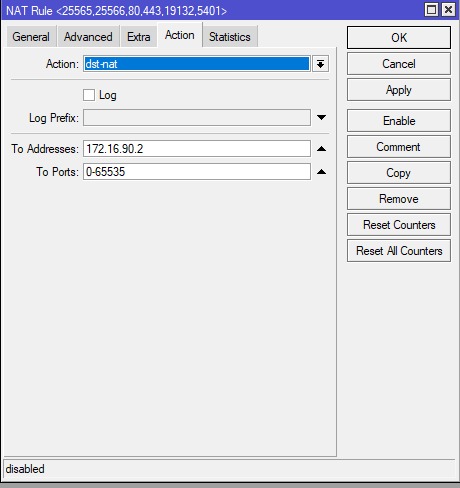

I have a problem, when I unlock port 80 on my RB, I can access my website normally via other external connections, but I noticed that I cannot access some websites from the computer where the XAMPP server is hosted.
What am I doing wrong?

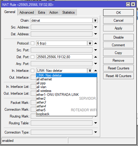

It seems (and it’s hard to verify as screenshot doesn’t show everything) that your DST-NAT rule isn’t very selective: it matches every packet with dst-port one of configured, regardless where the packet came from. You probably want to perform NAT only on connections from internet, so you should properly configure either in-interface or (better if your firewall still follows default concept of using interface lists) in-interface-list.
A couple of related notes:
  • you configured to-ports property and used whole possible range. This probably has different effect from what you expect: if to-ports is set as multiple ports (or range), then NAT may choose any of those ports as new (destination) port. If, OTOH, this property is not set, tgen NAT keeps (destination) port unchanged
  • while it’s fine to use single NAT rule for multiple services/ports, I suggest you to configure muktiple NAT rules, one per service/port. It0s simpky much more flexible, from performance point of view both ways are the same

I came to share with you how I solved it.
I put it in IN interface, where the internet link comes from, and it was solved.
