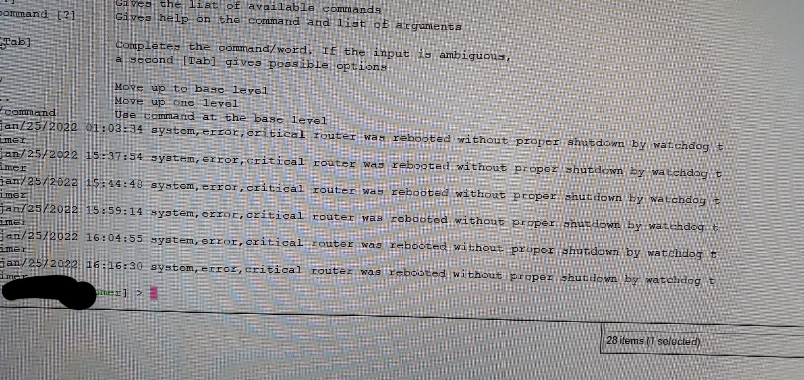

Hi all,
please help to review my router (RB750GR3) config.
i notice this because my main ISP is down, and i have sierra 3g USB modem, that i usually connect for sending sms but when such incident (main isp down) . i configured this modem for back up internet.
here is the weird thing,
when i change to USB 3G Modem, the router rebooted several time as this photo shown
i’ve attached the export files, is there something wrong with my config that causes the router to reboot several time ?

Your device most obviously goes unresponsive for a minute, so watchdog has to reboot it…
yeah the modem is not part of the supported list. but i think this sierra 885 is compatible tho, since i saw the setting how to make it works in this forum.
i would love to know what caused the unresponsiveness, but there is no output generated by the watchdog.
could be, but i was opening winbox all the time and watch the curent, temp, memory & cpu when it got hang, there is nothing that suggest sudden voltage drop.
the interface window packet just suddenly stop moving and not long the router rebooted.
