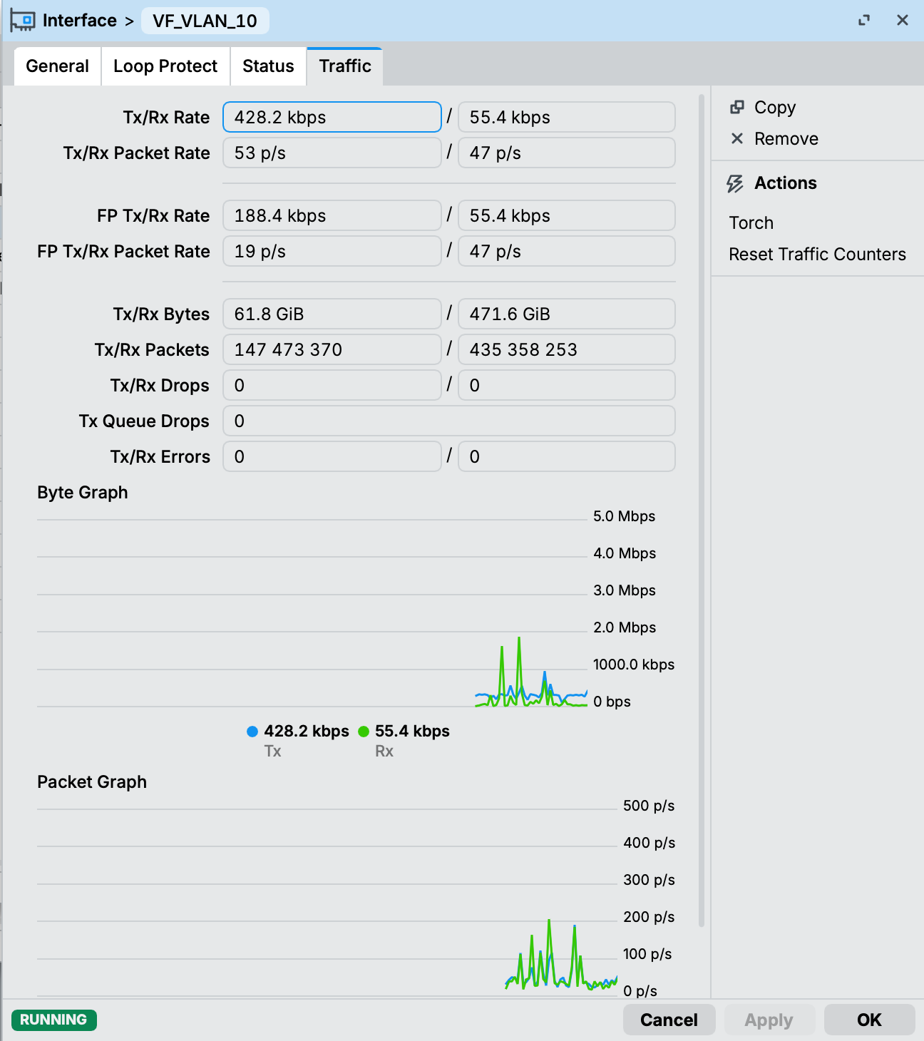

Where can I see the total amount of incoming and outgoing traffic on the Mikrotik HAP ax3?
Hello.
Where can I see the total amount of incoming and outgoing traffic on the Mikrotik HAP AX3?
Or the total amount of traffic received and sent via Ethernet/Wi-Fi interfaces?
Either version of Winbox or Webfig.

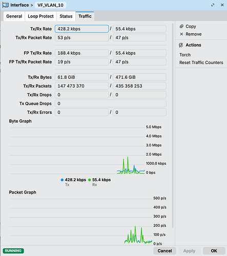

Double click on the interface you want to see the traffic for and go to the traffic tab. Tx/Rx bytes will give you the info you are looking for.
If you reboot or disable and enable the interface again the counter resets to zero.
Example from Winbox 4:
