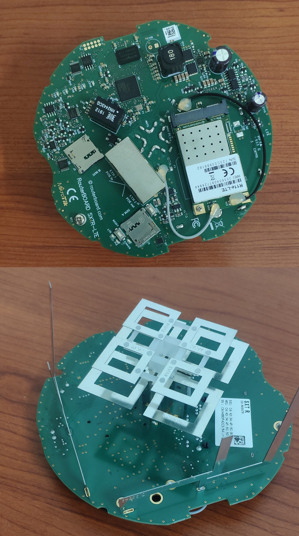

Where is SIMB on an SXT-R?
Picture would be nice, or at least a description of the location.
cdr.pl
Which model SXT-R is that SiB? I don’t have the tall bits around the edge on mine.
Do you know what band they are for?

About band, you need to check with which LTE interface comes the model that you pick. There are 4 modules possible:
R11e-LTE: 1 (2100MHz) / 2 (1900MHz) / 3 (1800MHz) / 7 (2600MHz) / 8 (900 MHz) / 20 (800MHz) / 38 (2600MHz) / 40 (2300MHz)
R11e-LTE-US: 2 (1900MHz) / 4 (1700MHz) / 5 (850MHz) / 12 (700MHz)
R11e-LTE6:1 (2100MHz) / 2 (1900MHz) / 3 (1800MHz) / 7 (2600MHz) / 8 (900 MHz) / 20 (800MHz) / 5 (850MHz) / 12 (700MHz) / 17 (700MHz) / 25 (1900MHz) / 26 (850MHz) / 38 (2600MHz) / 40 (2300MHz) / 39 (1900MHz) / 41n (2500MHz)
R11e-4G: 3 (1800MHz) / 7 (2600MHz) / 20 (800MHz) / 31 (450MHz) / 41n (2500MHz) / 42 (3500MHz) / 43 (3700MHz)
