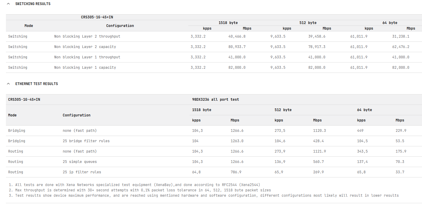

See the switching and ethernet (CPU) results for the CRS305

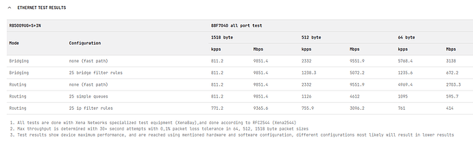

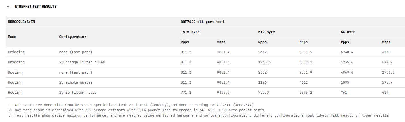

For comparison, see the results for the RB5009
