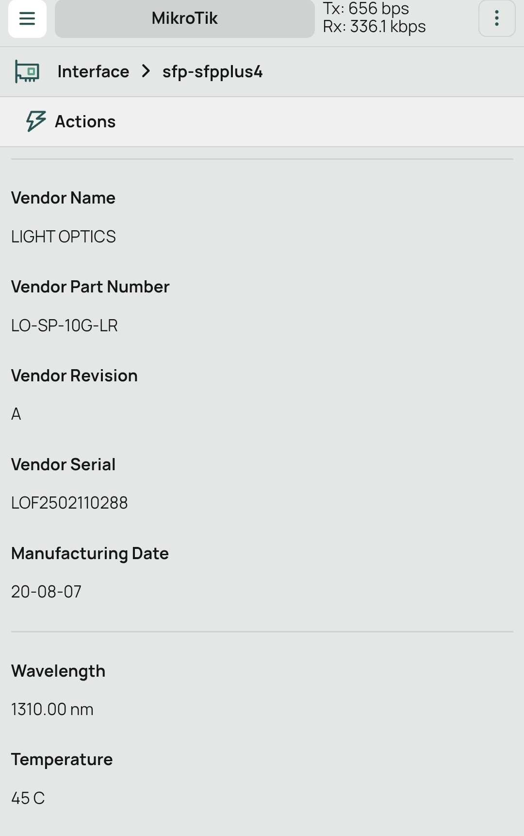

The SFPs that are cool are Light Optics LO-SP-10G-LR.
I ordered one more.
I wonder if there can be such a huge difference between supposed 0.8W single mode SFPs there must be also a difference between different 10G copper brands.
So I'm.starting this thread for people to post their verified "cool" SFPs. The only one I know about now is the Light Optics one.

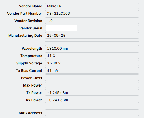

Speaking of running cables, Me personally i don't get why people stress about running multimode anywhere since singlemode is so cheap (i guess it used to be very expensive before so it just remained as a go-to statement when people ask), but the only expensive part about running SMF everywhere is transcievers in my case (because i decided i wanted to go with OEM mikrotik XS+31LC10D).

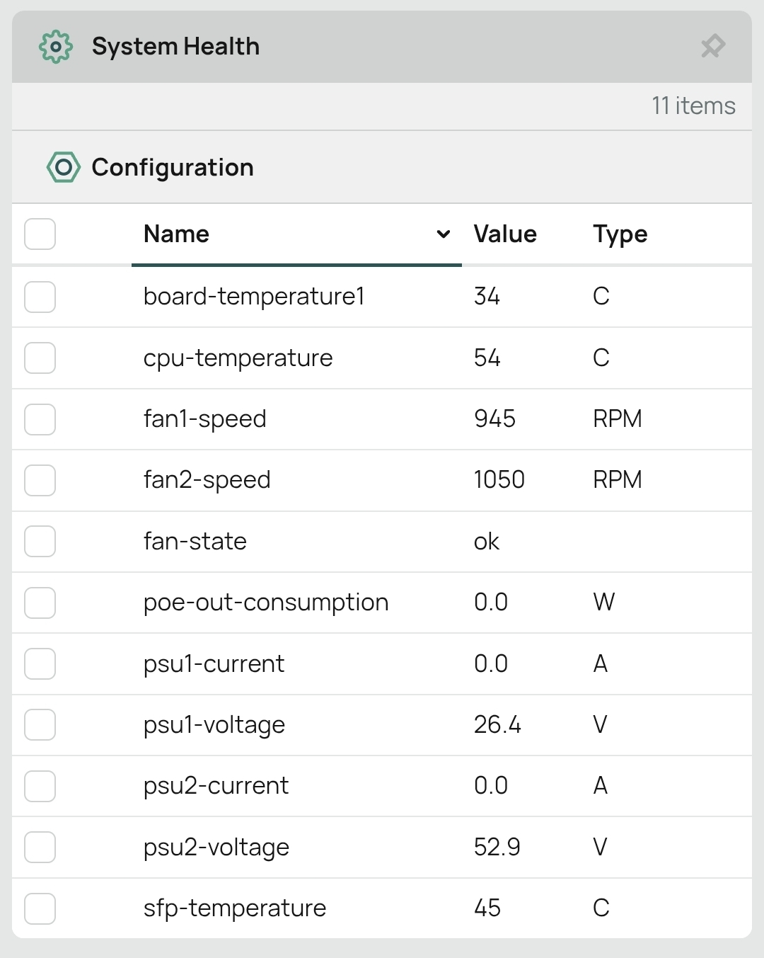

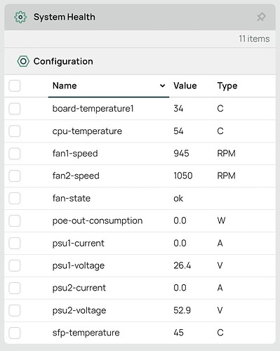

I bought Mikrotik's official 10gig transciever and a OS2A fiber optics LCLC patch cable from fs.com the whole run is like maximum 3 meters (the cable is 5m long) and i have huge slack everywhere in conduits. The uploaded pictures below is basically my temperature on SFP's (CRS310 -> health -> sfp-temperature)

That is a good temperature.
So it seems we have Mikrotik XS+31LC10D as a second cool running SM SFP in this thread :slight_smile:

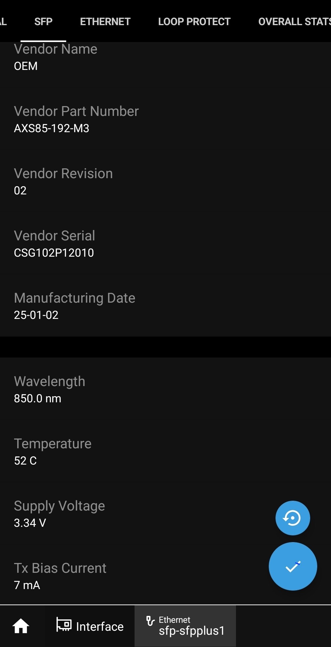

Mine is little hotter then yours. SFP+ with OM4 Multimode cable.
