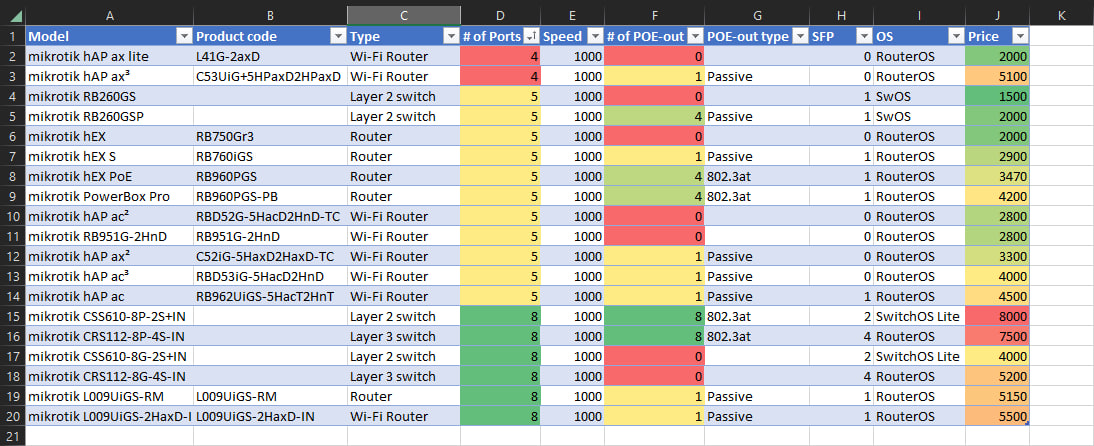

Which devices support S/FTP cables?
So we’re going to upgrade our LAN in the building using the CAT7 Ethernet cables - S/FTP AWG23.
We need the shielded cables, cause we might have some power cables laying around.
Anyway, the question is - which of the following mikrotik products have Ethernet ports that can be used with S/FTP cables, so that it will be grounded, if any?
Otherwise, as I understand if it does not support grounding in the ports itself, we would need to ground the braided shield in the cables ourselves separately.
We were going to buy such terminals:
But if devices don’t support grounding via ethernet ports, we might buy cheaper plastic terminals, if we’re going to ground the braided shield separately.
mikrotik CRS112-8P-4S-IN
mikrotik CSS610-8P-2S+IN
mikrotik L009UiGS-RM
mikrotik L009UiGS-2HaxD-IN
mikrotik CSS610-8G-2S+IN
mikrotik CRS112-8G-4S-IN
mikrotik RB260GSP
mikrotik hEX PoE
mikrotik PowerBox Pro
mikrotik hEX S
mikrotik hAP ax²
mikrotik hAP ac³
mikrotik hAP ac
mikrotik RB260GS
mikrotik hEX
mikrotik hAP ac²
mikrotik RB951G-2HnD
mikrotik hAP ax³
mikrotik hAP ax lite
