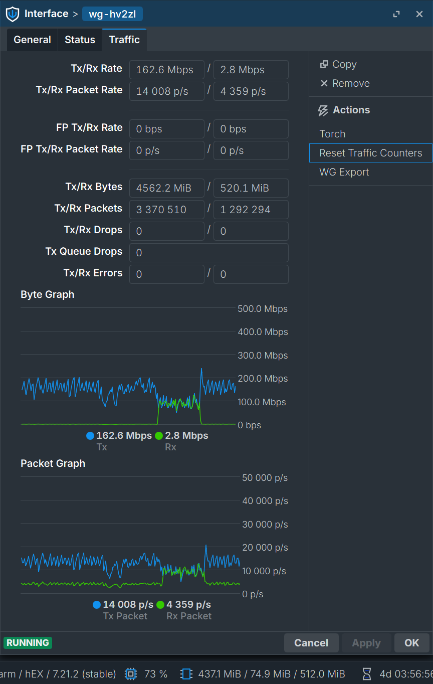

I have at one site hEX refresh E50UG (2 core)- with pppoe Internet bandwidth +/- 150Mbps, Wireguard operates at 140-150Mbps @ 65-80% CPU load.
