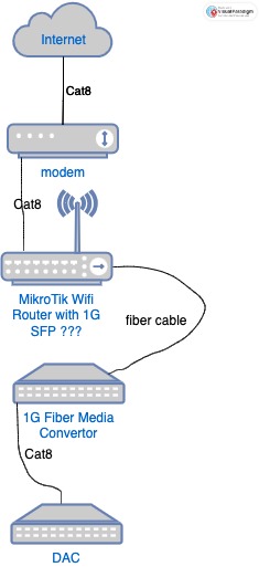

New here and a networking newb as well. Im looking to replace my homes ISP supplied Wifi 6 router and wondering which model you guys recommend.
The most important requirement is that It NEEDS to have a 10/100/1000 compatible SFP port for streaming network audio, a few open LAN ports, and provide decent coverage for my 2500sq home.
What are my options!

In your proposed drawing, you are intending to use fiber from the Mikrotik to a media converter, only to turn it back to a wired 1G ethernet connection. Why not just run a wired Ethernet connection from the router to the DAC? Unless your house dimensions are measured in acres, you are not likely going run out of the distance limit for a 1G wired connection over Cat-6.
Part two is a single WiFi access point for a 2500 square foot home is likely going to be pushing it. Might work, but likely will have some dead/marginal spots. I would be looking at multiple wired access points.

I am currently using 2 fiber media convertors and would like to be able to remove one and go direct from the router. Less powered boxes the better.

To me, this seems like two hAPax3 (or hAPax2’s, or mix), interconnected via 2.5G ethernet may be best. Your streaming audio will be fine on copper. It’s the Wi-Fi I’d worry about… AP closer to users is always better. Not only does it improve Wi-Fi experience by having two APs… having two similar routers gives you some options for redundancy/backup (e.g. hAPax3 has USB so could add a USB LTE hotspot down the road, can use VRRP so one router is always up if one rebooted for upgrades, etc).
