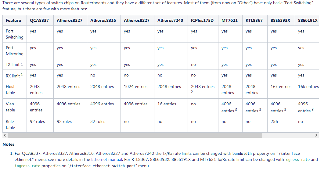

many chips have this capability:
https://help.mikrotik.com/docs/display/ROS/Switch+Chip+Features

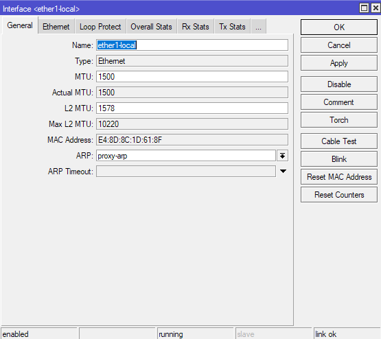

But i do not see “bandwidth property” in Interface-Ethernet on my routers
If mikrotik device doesn’t have switch chip, then nothing[*] can be offloaded to hardware. Where there’s switch chip built in, list of offloadable features depends on switch chip capabilities and ROS version.
[*] exception being certain types of encryption/decryption, used for IPsec.
Some switches and switch-chip supports rate-limit, but that its.
as I wrote above, I have routers with atheros8327 chip, but Winbox do not have rate limits settings (as described on MT site)

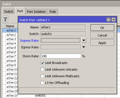

You’re looking in the wrong spot. It’s under Switch → Port:
Also, realize that the “Switch Chip Features” link posted above leaves out the CRS3xx series, which has even wider traffic shaping capabilities, documented separately.
Switch-Port also do not have these settings
Look in “Rule” tab …
maybe you won’t make such stupid assumptions?
Then your hardware is not among those with this feature. My screen shot is from a CRS328. I see similar settings on an RB4011, but my hEX PoE doesn’t have them.

Quoting the doc link above, “For QCA8337, Atheros8327, Atheros8316, Atheros8227 and Atheros7240 the Tx/Rx rate limits can be changed with bandwidth property on “/interface ethernet” menu, see more details in the Ethernet manual.”

Not sure being sloppy/lazy same as lying :wink: Let’s accept the docs may be wrong/old/outdate.
Since the switch-chip based TX/RX limits seem to be in Switch, not on the Ethernet port, at least in some cases. So central question is if you set the limits in the Switch section on atheros8327-system, do they work? If not, that’s a different kinda bug than the docs being wrong.
