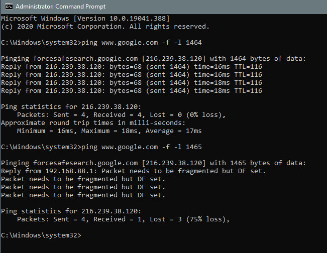

I am using hAp Ac (OS version 6.47.1) which receives internet from a FTTH PPPoE connection. On the FTTH modem the MTU is set as 1492. I have also set the MTU in hAP Ac as 1492. Apart from the option “MTU” I also see an option like “ L2 MTU”. Do I need to set that too? Or just leave it as it is? And Do I need to set the MTU on every interface as seen in first image? (I have found that the MTU size which doesn’t cause packet loss is 1464 by using the ping command “ping www.google.com -f -l 1492 and the results are as given below.)

And a comment on your ping tests: the packet size set on command line is payload size … IP stack then adds IP headers … and packet with headers has to fit MTU. The non-working test says that packets had DF set. DF stands for “Don’t Fragment” and if that’s set on IP packet, routers won’t fragment it, they will rather drop it and send ICMP message about it. So your command is great to see what’s realistic PMTU (but you have to add IP overhead and with ICMP messages that’s 28 bytes - 20 bytes for IP and 8 bytes for ICMP).
