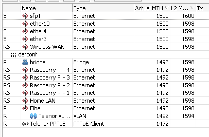

Here is the screenshot of my interfaces, in case it can shed light on anything.
You have only to "determne the MTU from packets that are returning:
/ip firewall mangle
add action=change-mss chain=forward in-interface="Telenor PPPoE" new-mss=clamp-to-pmtu passthrough=yes protocol=tcp tcp-flags=syn
The MTU seems strange because the VLAN is 1492 and so the PPPoE MTU could be 1488.

The change-tcp-mss=yes setting in the default and default-encryption PPP profiles will sort out MSS clamping on the PPPoE connection (PPPoE client interfaces default to the default profile).
The PPPoE client MRU/MTU should be adjusted to best fill any segmentation imposed by the WAN technology, often 1492 if baby jumbo / RFC4638 is not supported.
Standard ethenet interfaces should always have an MTU of 1500 unless using jumbo frames, setting it to less will randomly break connectivity and additional mangle rules will not fix ensuing LAN-to-LAN problems.
Whenever I see an MTU set to 1472, I suspect that whoever set it learned networking on Cisco and were used to the cisco (or MikroTik) ping size syntax which specifies the packet size. Windows ping -f -l 1472 generates 1500 byte packets (1472 icmp payload + 8 byte icmp header + 20 byte ip header). Same with linux ping -M do -s 1472
Many wrong examples on the web for “determining the MTU with ping” where it is suggested that a successful Windows ping -f -l 1472 followed by an unsuccessful ping -f -l 1473 is an indication of MTU 1472. But that is not correct, that indicates the MTU is 1500 (you need to add 28 to get the MTU).
Here’s one example of incorrect advice. Use Ping to Find a Path’s MTU (and wayback machine link in case it gets “fixed”)
So unless there is another explaination, it seems that the link’s path MTU is 1472 because someone has a router’s MTU set to 1472 when it should be 1500. (not your router).
More links in this post about why mss clamping exists.

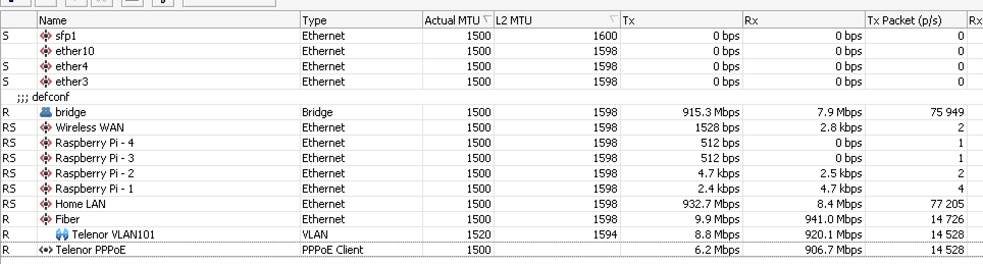

I have now set MTU’s as shown on the screenshot below and things seem to be working. I have also disabled the mangle change MSS rule for now. I will keep you posted during the day, cause I can almost swear that I’ve tried this before and that the outcome was different. So something feels really strange, let’s see what happens throughout the day.
Also the fiber to 1520 MTU.
Seeing the MTU of the PPPoE is now 1500, confusing but if it works then it works. Test is with ping in tools. Ping to google.com and set the packet size to 1500 and mark the do not fragment both in the advanced tab.
Then start and see if the ping packets are passing.
I tested it here and apparently it is sufficient to set the MTU of the VLAN while leaving the ethernet MTU at 1500.
It seems that the ether1 MTU is only for direct transmissions on ethernet and for any VLAN the MTU is taken from the VLAN interface and it “does not have to fit in” the ethernet MTU.
So the configuration is actually correct, even if intuitively one has to have a larger MTU on the parent interface to allow larger MTU on the child VLAN.
(as of course is the case for e.g. tunnel interfaces)
Next to the used MTU is the L2-MTU and that one is MTU that the interface can handle. As you wrote setting the VLAN higher is allowing the PPPoE sit above 1500. Then having a higher actual MTU on VLAN you would expect that RouterOS would reflect that in the actual MTU of the ether interface.
But then I have experience with MTU being displayed that are not the actual ones. I had to set manually, an MTU and then ping to see if had indeed the a 1500 MTU while RouterOS was displaying a different actual MTU. One of the last Betas had an fix for that when using PPPoE if I remember that correctly.
There should be no need to change the MTU of either the base ethernet interface (Fiber) or the VLAN on top of it (Telenor VLAN101) as this only affects layer 3 IPoE packets, PPPoE is layer 2 and easily fits within the L2MTU of 1594.
