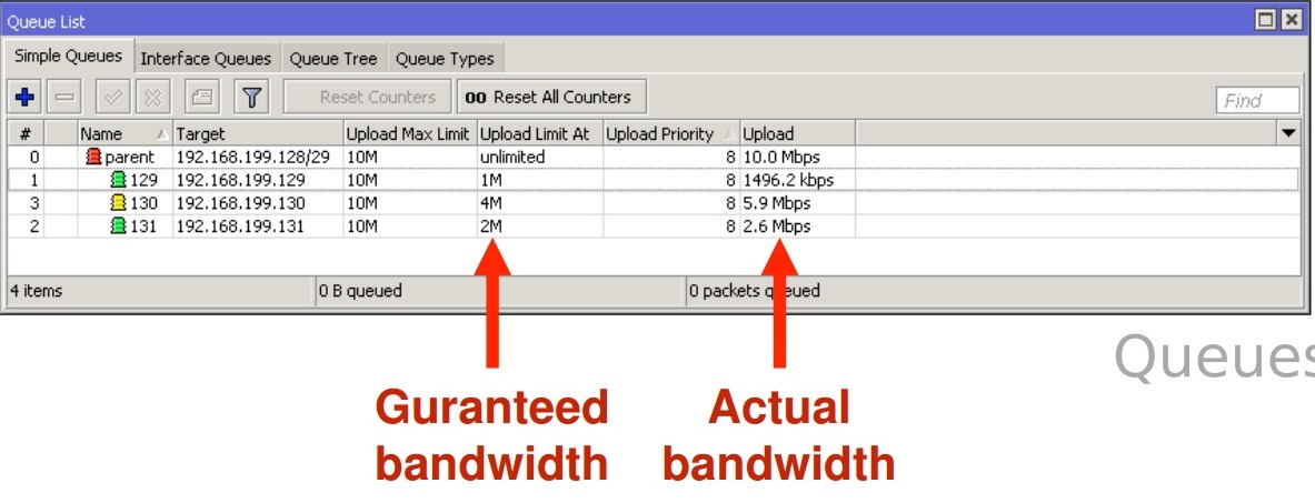

Yes, as you said you should make parent que. then set the priority to 1 for A. it should work. also you can use limit at option. limit at is guaranteed speed for target.

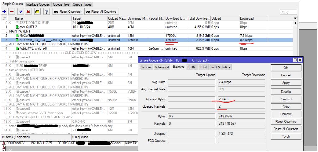

Thanks, This did help quite a bit and is what im using with success in my setup, however i still seem to be having issues with the “download-limit-at=Xmbit” setting,
Even with “download limit at = 17500k” , Im still seeing packets queued when only 8.3mbit of data / usage are passing-
This wouldn’t be a big deal, but i can clearly see from my SNMP and other data points, that with the queues ON, my load will will run between 7-11mbit with clear bursts and spikes to 12 or 13mbit. With this queue setup on, the bursts and spikes are not present and the load is much more of a flatline/plateau between 7-11mbit.
I was under the assumption no queuing would kick-in till 17500k (btw, i did try lots of different settings, setting the download-limit-at a little below the download-max-limit has given me the best performance, though still not what i was expecting). please see screen shot below, i can provide images of the Bandwidth graphs as well if needed.
thanks
