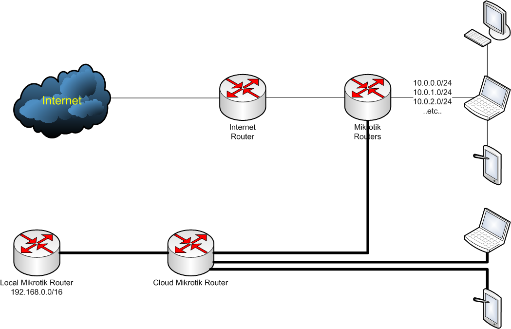

I want to create a VPN cloud Mt router, connected to our Local Mt router, so other Mikrotik routers and individual devices can connect and join the network.
You can see in the picture what i want to do.. My question is, what type of VPN to use ?

The bullet prof option (connection wise) is OpenVpn. It transverses NAT and double NAT without problems. You can pile any number of clients behind a single NATed IP, and it will work . It has clients to Windows, Linux, Android, MacOS and (I think) IoS.
But it is not without problems.
  1. Mikrotik doesn’t do hardware acceleration. So, the CPU usage is higher.
  2. Mikrotik implementation is TCP only. This gives You a slower speed than would be achievable with a UDP solution.
  3. Mikrotik implementation doesn’t have compression, so it’s more bandwidth usage than with compression.
  4. The only way to use IPv6 inside an OpenVpn tunnel is using the TAP interface, and attaching it to a bridge. But this is a layer 2 interface, so you don’t get client isolation.
The efficient option would be IPsec. You can use it pure or encapsulate something in it. L2TP/IPsec is quite popular. It is UDP, fast, has hardware acceleration and works very well.
  1. The setup is more complex
  2. Doesn’t play very well with single NAT, and double NAT is out of the question.
  3. You can’t just pile how many clients You want, behind a single NATed IP.
  4. Sometimes it gets blocked by firewalls. This can be a problem for your road warriors.
There are some other options. I’m sure someone will help with them here.
One thing to point out also is if the hotel or other site you’re at when launching the vpn has the same ip addresses as you, that would cause problems. That might explain why it would not work on occasions.
