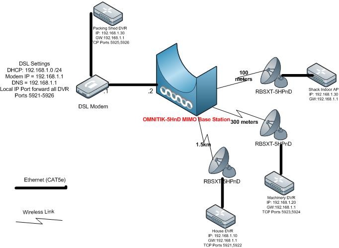

Hi All,
After some advice on the best wireless mode to create a WLAN with OmniTik 5hnd and 3 RBSXT-5hnd.
This WLAN is primarily used for remote CCTV viewing from 3 different DVRs within a decent size property (50 Acres).
My current DSL modem to do DHCP,DNS and port forwarding for DVR Ports.
I have attached a little Visio diagram of the proposed logical setup. I’ve been looking at all the good articles on here and I’m getting confused on how I should try to implement this!
Full mesh ?
One Bridge (AP) then 3 client stations ?
Others?
Would appreciate some guidance of this topic
Thank you
I followed JTECH Guide on WISPforum.net and got all device communicating with eachother. I’ll play with NAT and port forwarding now :slight_smile:
