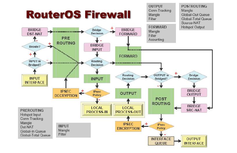

I have touched Mikrotik for several months,but now,frankly,I have still always been haunting with these some basic but very important concepts like input,forward,output etc. I deeply believe that if these concepts I can thoroughly understand, I can’t get even further.
Like the picture shown below,there is a crossroad after “prerouting”, router had to make a decision that some packets sent to “input” chain,and the others go through the “forward” chain…
Question one:which kind of packets should go to “input” chain? In my view,every packets should go into the “input” chain to be processed in the router and then flow out the router.
Question two:What prcesses would take in the “local process-in” and “local process-out”?Give me some examples please.

There are three predefined chains, which cannot be deleted:
  • input - used to process packets entering the router through one of the interfaces with the destination IP address which is one of the router’s addresses. Packets passing through the router are not processed against the rules of the input chain
  • forward - used to process packets passing through the router
  • output - used to process packets originated from the router and leaving it through one of the interfaces. Packets passing through the router are not processed against the rules of the output chain
http://wiki.mikrotik.com/wiki/Packet_Flow
“Local Process IN” - last point in packets way to router itself, after this packet is discarded
“Local Process OUT” - starting point for packets generated by router itself
examples: ospf sessions, routeros web server (webbox), winbox server, proxy, etc
