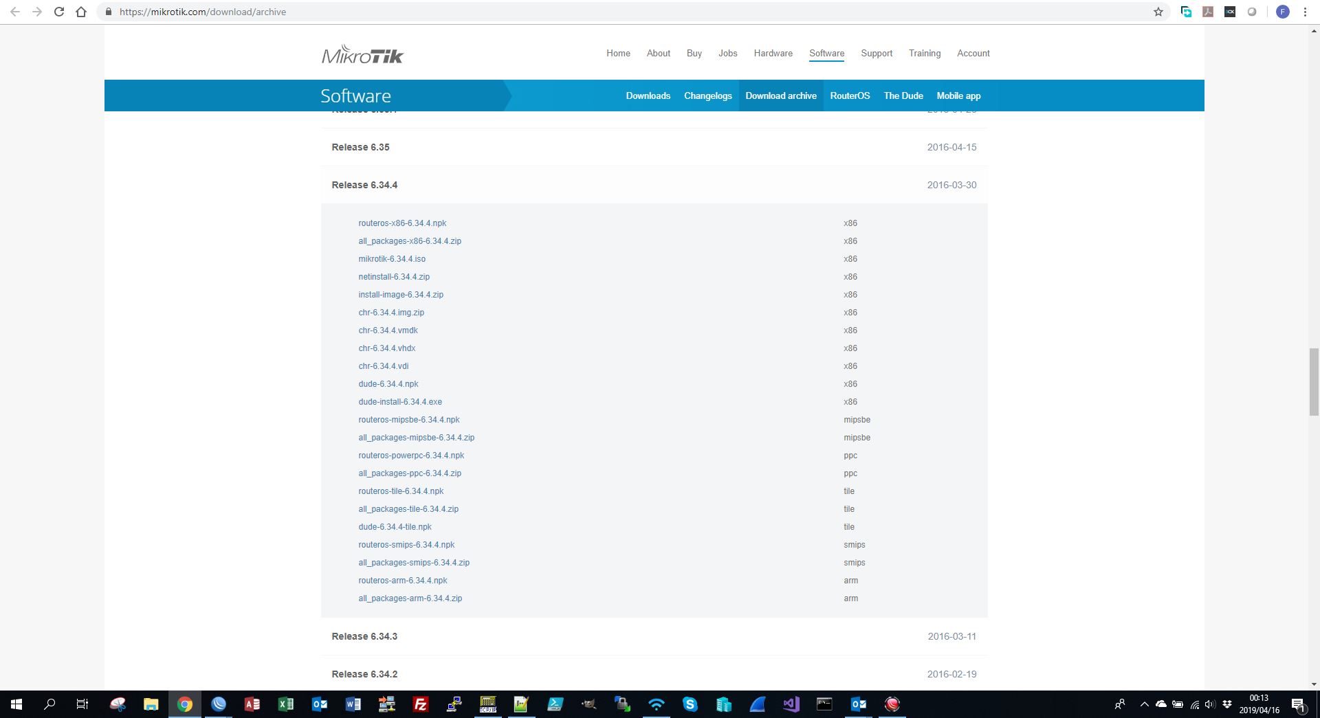

https://mikrotik.com/download/archive
yes I checked there if you click on 6.34.4 I get a 404 error
the all-packages .zip files seem to work so you could download your architecture that way and then just upload the relevant packages that you have installed, bit of a round-a-bout way to do it though.
none of the files in that zip are working for me
what file would you use for a CCR-1009-8G-15-15+
