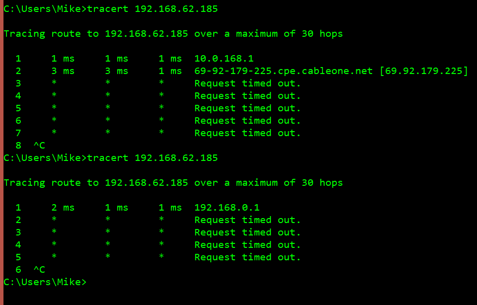

One more thought… We have a static IP from our cable company for internet. Cable modem plugs into router WAN port and is configured for that static address. I went and plugged my laptop directly in to one of the other ports on the cable modem and it handed my laptop a 192.168.0.2 address. I wonder if this might have something to do with it? If cable modem is nating or something and so is my router? Just a thought. Perhaps the 192 address in my logs is from something on the cable company side?
On my Mikrotik, I would think even if there was a device that was outbound with 192.168.62.185.
So… check this out. I think we are getting closer. The first traceroute is from within my network. Isnt that hitting my cable modem? The second traceroute is plugged directly into the cable modem and seems to just time out. Thoughts?
Don’t give up yet @CZFan and @R1CH
