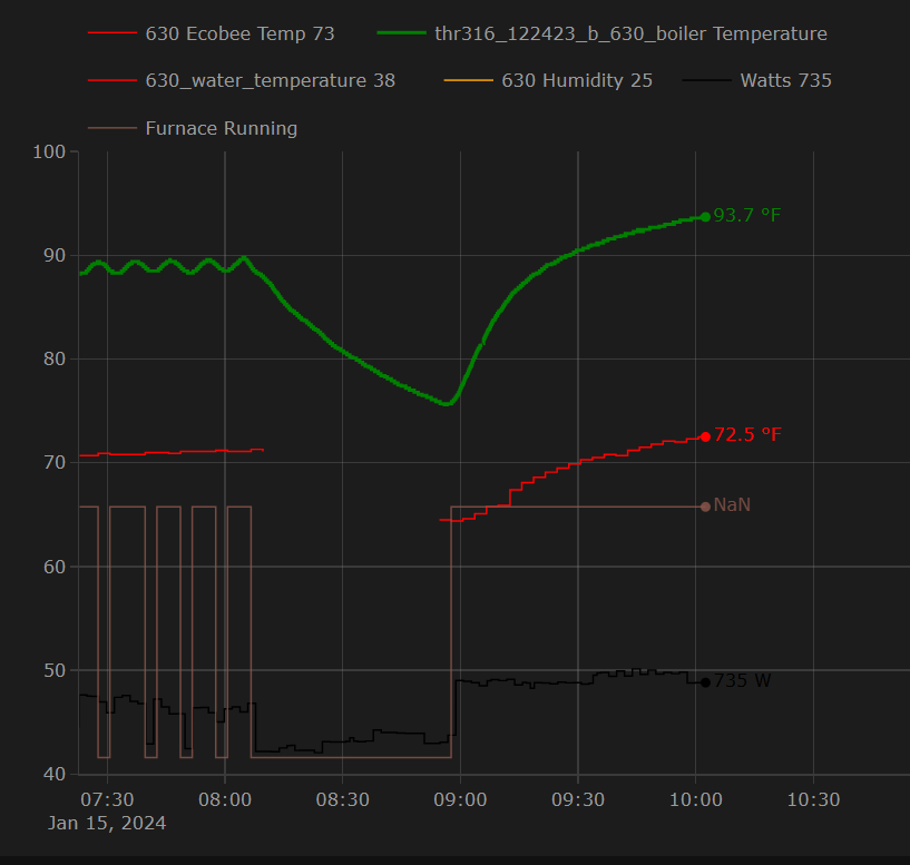

Following up on my wifi disconnect/disassociate problem, I am happy to report the problem was all because of my fingers:
Simultaneously with troubleshooting this wifi problem, I have been troubleshooting why my furnace is short cycling (runs for 10 minutes, stops for 2 minutes, starts again).
Luckily, I am data-addicted, so I collect the data showing the times of each of these, and of course the MT device knows when the ecobee disconnects/reconnects.
I overlayed the two and sure enough they correspond.
Seems the transformer that powers the ecobee was wired into the burner power, and, for reasons I do not understand, every 10 minutes there was an interruption in the power, causing the ecobee to reboot.
I just rewired it (you can see it on the graph from 8-9am) and it’s been running for an hour without interruptions – as has the Ecobee tstat.
