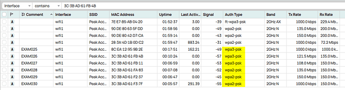

Seeking more knowledge here of authentication and encryption. Currently remotely diagnosing a training room with six identical (cloned) mini-PCs connected currently to an hAP ax lite LTE6. Three of them have connected using WPA2-PSK and three using WPA3-PSK.
What situation leads to them negotiating different authentication types? They’ve all got very similar signal strengths.

Later yes, they can all work on just WPA3-PSK so the question is still why did some of them negotiate WPA2-PSK when WPA3-PSK was available.
