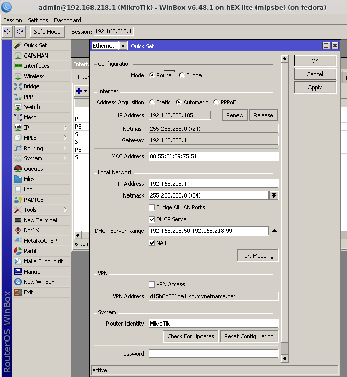

Why can't I make my hEX lite into a router?
Edit: I am not sure why the attachment I added is not showing. The post makes no sense without it. Here is the attachment on imbgg:
https://ibb.co/Gd973B8

I am trying to user a “MikroTik RB750r2 hEX lite” as a router. The unit can ping anywhere and successfully upgraded its OS. But when I try to ping out from a workstation, I get
$ ping 8.8.8.8
PING 8.8.8.8 (8.8.8.8) 56(84) bytes of data.
From 192.168.218.1 icmp_seq=2 Redirect Host(New nexthop: 192.168.250.1)
And the client does get a DHCP address from the hEX Lite, but I have to unplug the WAN cable, or I get an address from the DSL modem providing the WAN connection.
What am I doing wrong?

I connected my DSL modem to the left most port, labelled “Internet”. I connected my workstation (Fedora 33) to any of the rest of the ports (tried them all, except the Internet port).
I am using winbox through Wine (I can not figure out how to open a terminal to the box).
I notice that the thing thinks I am in bridge mode, not router mode. I can’t figure out a way to change it to router mode.
I have pressed the magic reset button and powered back on several times. Same result after the Quick Config.

Why do you think it is in bridge mode? You can see that your WAN port is in another network segment from the LAN part. Pretty sure it is in router mode.

I am not in front of the device, so I can't give the exact wording, but several of the categories (Network? Interfaces?) say "Bridge" at the top.
The first time, but I pressed the magic button several times and redid the quick set. I look at various menus, but the made no sense and I could not find any of the setting that Quick Set did, so I did not change anything, several times.
