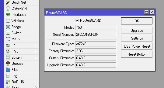

Why can’t I see the PPP folder/card?
RB750
SN: 2F2C0165FC84
Firmware TYPE: ar7240
Factory firmware: 2.36
Current Firmware: 6.49.2
Thank you.
RB750
SN: 2F2C0165FC84
Thank you.

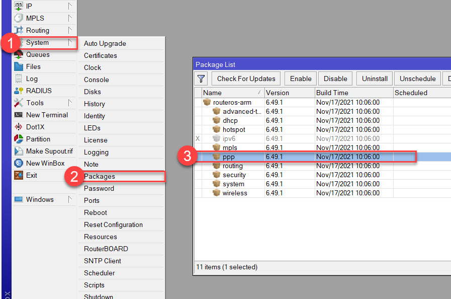

You need to take a look under “Packages” to install / activate PPP
After that it should be availeble in the winbox menu,

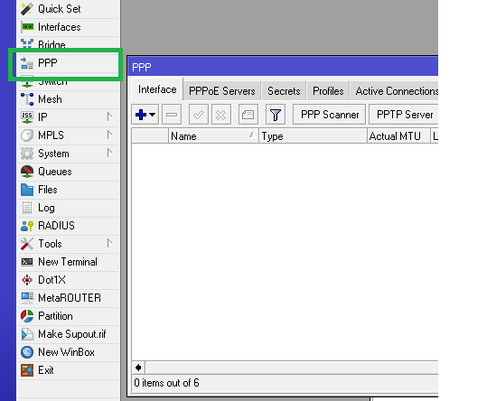

Perfectly. PPP is visible.
Very thank you for your advice.
