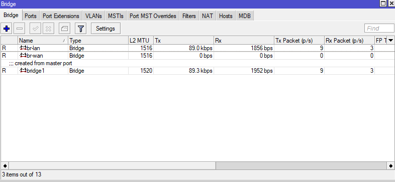

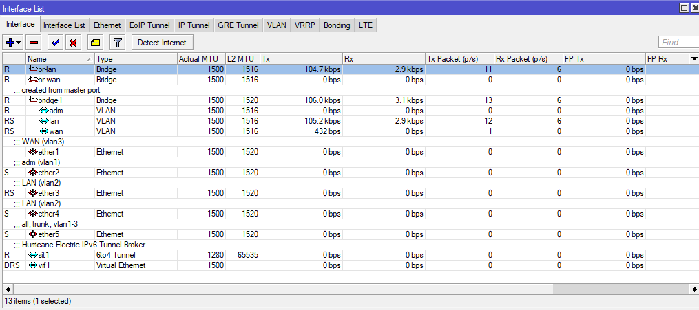

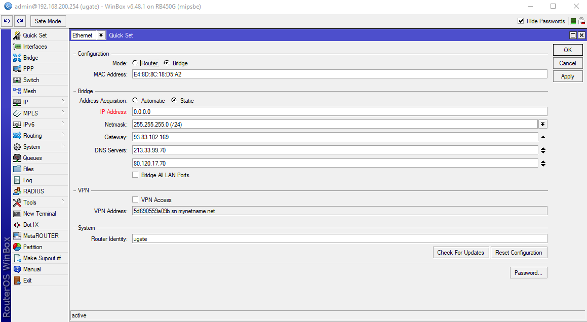

When I upgraded to 6.48, the router LAN and ADM interfaces worked but WAN did not work. After some time I found out that the upgrade messed up the config completely. All of a sudden there is a bridge1 with comment “Created from master port”. In “Quick Start” (although I don’t use it) it can be seen that suddenly the WAN IP and the LAN IP is missing.
The VLAN interfaces are now members of this unwanted “bridge1” device which previosly were member of ether1.
Here are the screenshots that I too from the upgraded system:
It’s totally messed up so I had no choice than downgrading to 6.38.7. As an added bonus, this endeavor made my OpenWRT metarouter (including its entire configuration image) vanish, instead leaving a RouterOS metarouter with the same name behind.

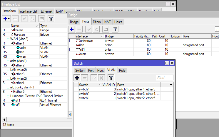

I did this setup 8 years ago or so so I do not remember all the details. But br-lan and br-wan are bridges for WAN and internal LAN interfaces. Bridgde ports should be a) normal network ports b) VLAN tagged network ports c) various things like vif, sit or VPNs.
The way how I did it so far was:
I configured the switch using the port master method such that ether1=wan, ether2=adm, ether3=lan, ether4=lan, ether5=all (with VLAN tags):

VLAN IDs: 1=adm,2=lan,3=wan
The adm interface is not bridged (it has its IP assigned directly) but for WAN and LAN I created a dedicated bridge br-wan and br-lan so that I can bridge other things like VPNs, vif etc:
