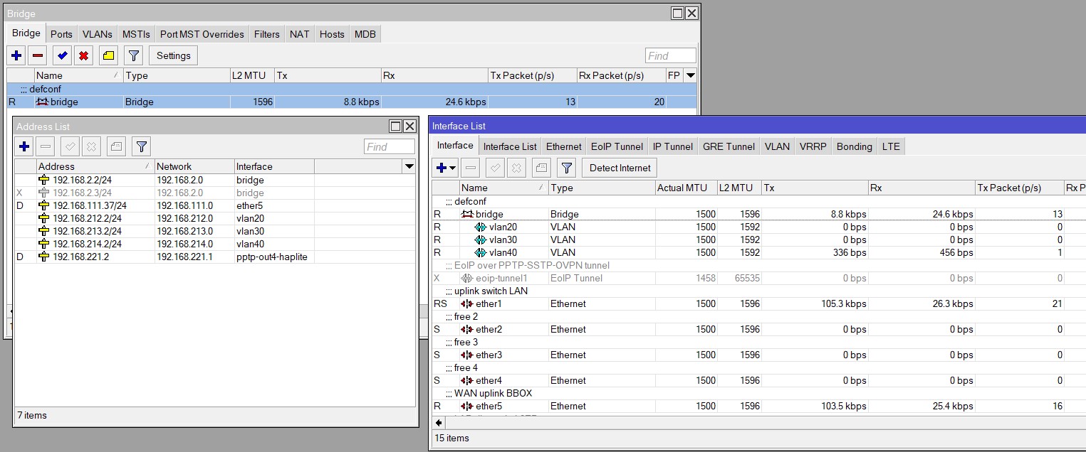

My WAN port (ether5) is not on the bridge, with a FW rule to allow me to come in with WinBox. So I can change and peek without losing connection.
Ethernet ports on the bridge (1 to 4) are practically unusable for IP.
WinBox Neighbors does show the router with 0.0.0.0 IP address on ether1, and can be connected through there via MAC!
Normal setup … (ether1 is LAN connected, ether5 is WAN connected)
Bridge disabled … (find the differences)
