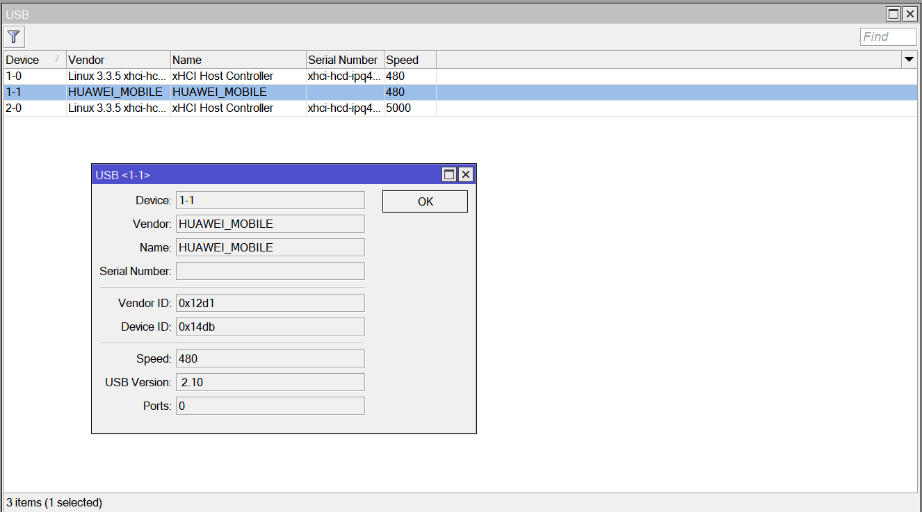

Show system resources usb print , to detect what that USB LTE device is.
Herein is the sreen with usb resources…

12d1 14db probably say about E3131, my works proper but I re-flashing it with some mode firmware… and use it as usb1 device with ppp-out1.
I not know that E3131 (or maybe you have other USB LTE unit ? ) support a Hi.Link and be exist as lte1 interface. It’s new for me.
