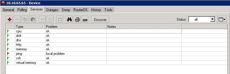

Every “ping” is failing, with the cryptic message “local problem”. However, command line ping works fine.
I installed the 4.0beta2 on a system that has not had The Dude - running Windows Server 2008R2.
I imported the settings from 3.6 on a different system (though I don’t think that is relevant).
The following shows The Dude error:

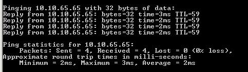

The following shows command line ping (to the same device) working:

  • a protocol trace shows that no ICMP messages are emanating from the server, except when command line ping is used.
I cannot find any explanation for the error “local problem” and thus I have no idea how to fix the problem.
