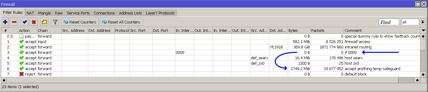

Why interfaces don't work for firewall rules?
I’m trying to pass all traffic entering an interface (rule #3) but it’s catching nothing:
Instead all traffic is caught by the later rule (rule #6) which just like the intended one, doesn’t specify
src.addr
. Why specifying the interface breaks the otherwise identical rule? They are processed in order, aren’t they?

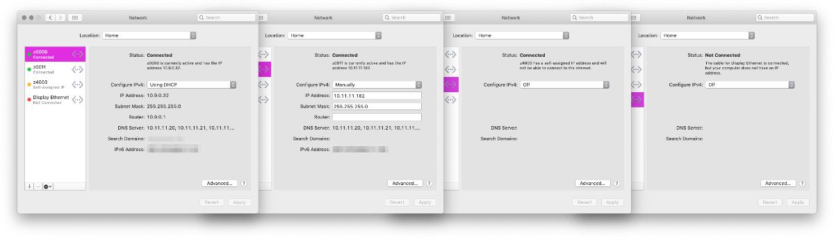

It seems not to obey the firewall at random or something; I just blocked myself and I still can communicate out.
I have full access to what shouldn’t be allowed–everything outside of RFC1918. I doubled-checked the machine’s network and everything. IDK what’s up. :confused:

The configuration posted and screenshots don’t correspond exactly, however the rules are working as expected - in the image ‘Screen Shot 2021-08-04 at 04.33.00.png’ the traffic source address is 10.0.0.32 which will match src-address-list ‘rfc1918’ referenced in rule #1 and be accepted, so never reaches rules #4 or #5.

So I went back on this haphazard log I had been keeping of what I’m setting up, tweaking, a few screenshots: at some point I that RFC1919 was in the next column i.e. destination, after posting though I focused away from this a bit since things were online it could wait. Some routes started failing, traffic started to get blocked. It took a while to trace it down to mismatching DNS which the firewalls and reverse proxies depend on. Bare-metal Domain Controllers had stopped replicating with virtualized DCs, I traced it to non-working IPv6, further traced it to no multicast traffic crossing in/out the hypervisor cluster. The CHR was occupying the place of the device that handled this before. I installed the multicast routing module (PIM), rebooted and now the rules were working. I hadn’t configured anything yet, IPv6 layer 2s still split.
I rebooted again, and rules stopped working. At that point I got desperate selected all rules and deleted them. Started over copying rules and I assumed that was when I missed putting RFC1918 in scr rather than dst. Perhaps the best thing is that to draw nice curve angles I blew the screenshots over 400% and I still missed it!
