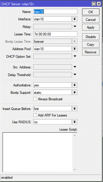

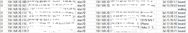

I have checked both systems – hEX and CCR – and the behavior that is written about is not what I see — both systems are delegating leases incrementally starting at bottom up
following pics show my hEX DHCP server and dynamic address assignment:
You have option “Insert Queue before” set as “FIRST” so you have bootom-up order … strange you have this option where it should be. What is your ROS version?
Currently I am on ROS 6.42rc49 … however I initially configured the hEX starting with ROS 6.41.3 which had the exact same behaviour.shown in my pics.

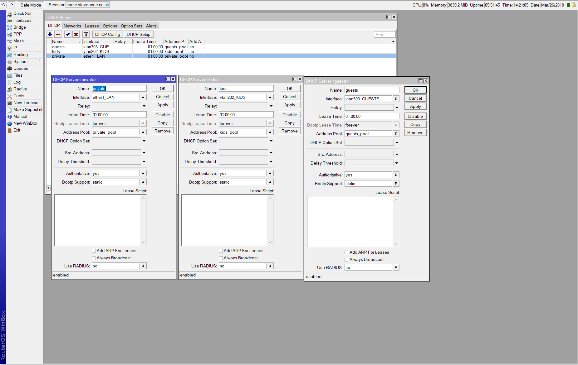

Yes looks like some GUI changes from 6.41.3 to the rc …
So I’m not going mad then? This is my CHR on 6.41.3. I have 3 DHCP servers all running and none of them have this option for IP assignment as per the previous poster. Must be an “RC” thing. Probably a good thing as I’m waiting for 6.42 to go current anyway to get the vmware-tools functionality.
