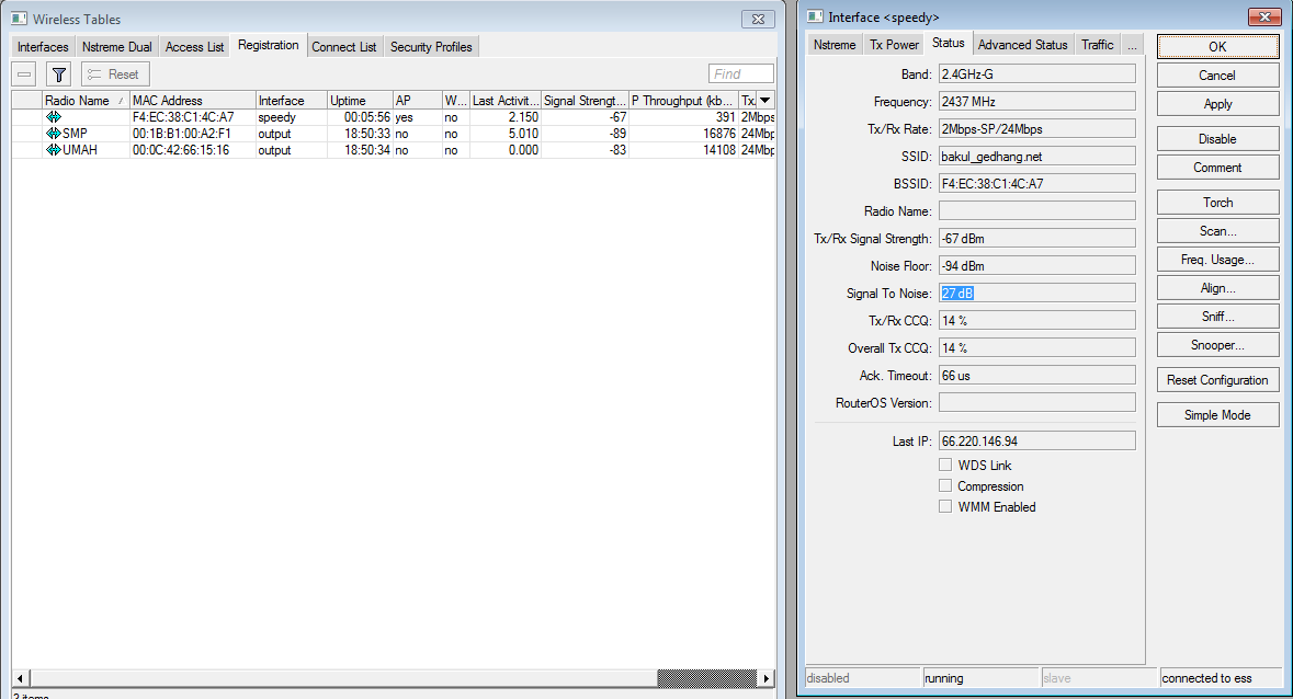

I have the same problem with RB433, but I don’t think so, it caused by signal strenght, i got -66 signal strenght, but p. throughput is 450.
-66 could be a very very good signal.
how is your snr ?
This is The screenshot, but sometime I got good P.Throughput
your signal level is 20db better than other registrations.
it is not problem of signal level.
your ccq is too low.
the problem seems to be at client side
I don’t Know, Any Suggestion ?
could be an interference.
try to change frequency
not about frequency
I found another forum to change adaptive noise immunity (ANI) and its god enough
