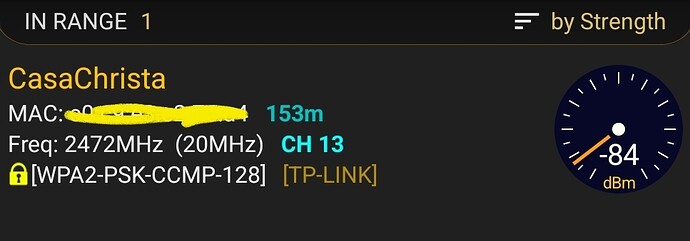

Why my hAP AC2 can't see this network?
There is this 2.4GHz network:
I wish my hAP AC2's wlan0 to connect to this, but it is:
  • Not able to scan it
  • not able to connect it manually (with SSID and security profile configured)
What could be the reasons behind this? Taking into account that distance between them is about 5m, without walls. Ie. They are in the same room. AP is on ceiling, MT is on desk.

That should help indeed, thank you!
I selected superchannel instead of manual txpower and added 2472 to scanlist and it solved it.
